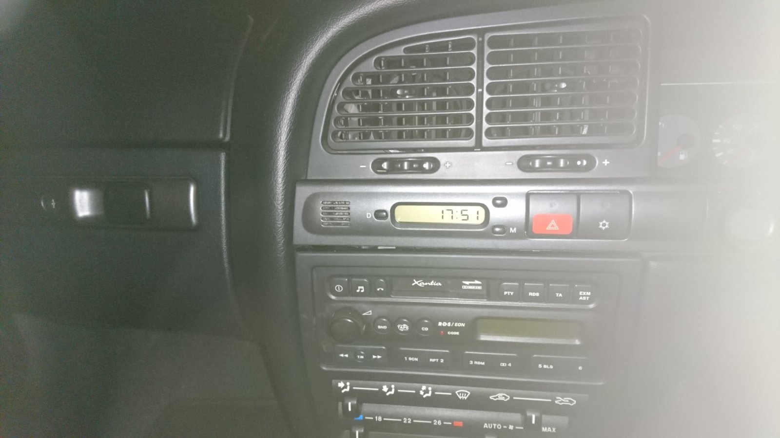

Picture of the grill taken from my car today time can be seen on the clock

Now i have looked at it in situ memory has kicked in, i think that if you remove the radio you can gain access to the rear of the senor/fan assembly, it is much easier than removing the trim panel and i think it is a push fit so will have a tab that need squeezing to remove it but could be wrong and you can have it hanging connected to check it works
*** Edit the pic is from a MK2 but still think radio removal will work on a MK1 ***

thank Colin, as luck would have it I already have the radio out to fit a cd player in! Ill check the sensor/fan assembly tomorrow
