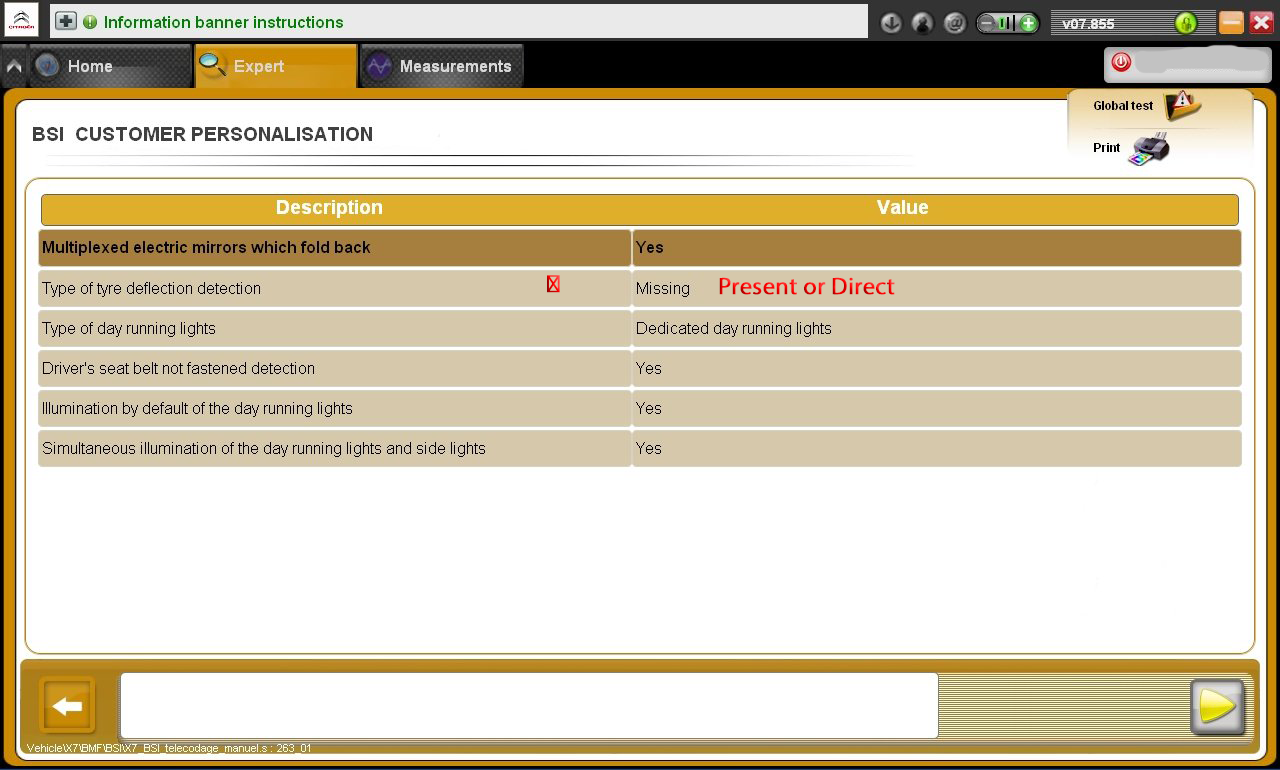

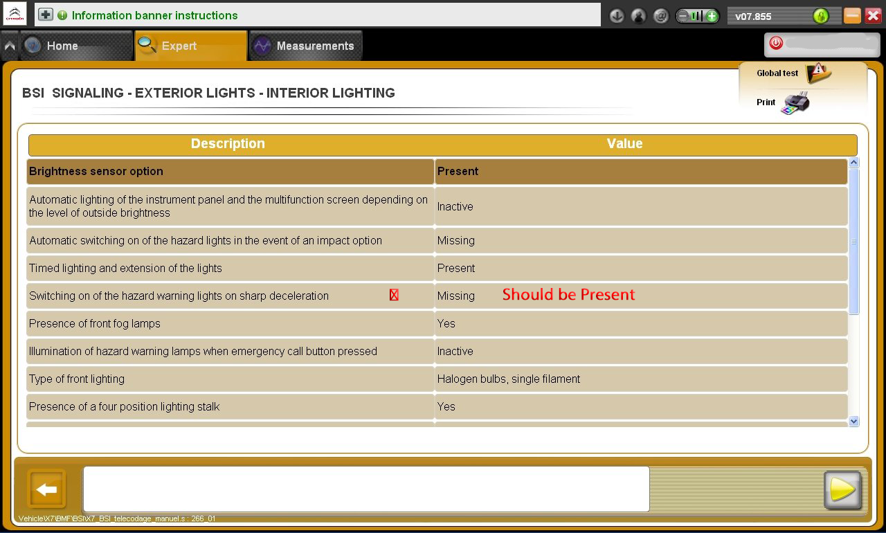

Right, here you go.
Remember that some of the lists just show which ECUs are present. Some of the other screen shots show what the BSI is configured to.
I have therefore compared your vehicle as it shipped with correct options, (accounting for parameters that must be set for Finland), against the changes for the RNEG system you have fitted.
You also have an incorrect setting for directional headlamps that you do not have (you have static halogens, not bi Xenon directional headlamps), so I have picked up the settings to change.
Your seat belt warnings were all incorrect too and your Inflation detection was disabled.
I think I have now highlighted the correct settings you need for the Audio and Telematics.
There are a lo to duplicates on the pages and you may find that once you have corrected the parameters, they may update t he other sections. At least with my amendments you now have a reference of what you changed.

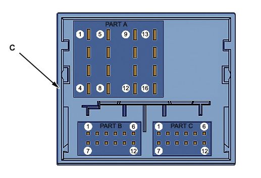

As for the microphone - you'll have to buy a mic if it's not there and wire this into the back of connector block 'Part B':
Pin 3: Microphone Earth
Pin 9: Microphone Input Signal
