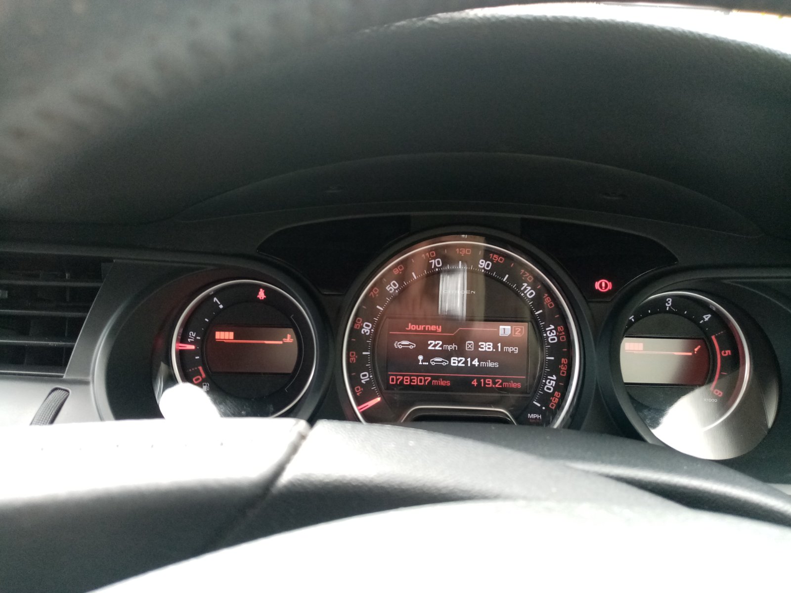

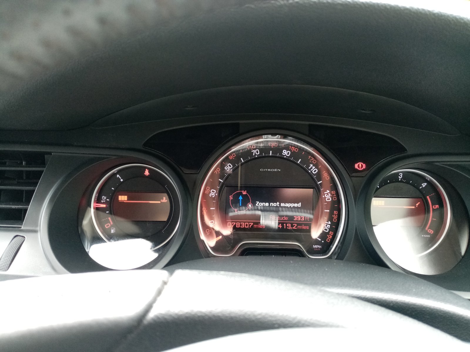

Update
Hi all
Just an update regarding retro fitting an upgraded instrument cluster.
First of all it was not as easy as I first thought because you have to remove the top and bottom steering column trims x2 torq screws then remove the screws securing the cluster in the dash board x4 torq screws
The cluster has one electrical connection that you can just about get to without removing the cluster trim
You then have to remove the comms unit because there's not enough room to remove the cluster from behind the steering wheel
Four torq screws secure the cluster to the trim and access is tight, the cluster then comes away from the trim.
Please see photographs of finished installation (well apart from cleaning) I just need to connect to lexia and check settings
A question for Marc if he would be so kind
What settings will get me the maximum information on the cluster
I hope this helps someone else in the future
Note
Confirmation that no Vin appears to be stored on cluster and no errors on Lexia
Kind regards
Steve
Note
Kind regards
Steve

The settings are not optional Steve, they are based on specific equipment fitted to your car, so with the MyWay upgrade you have done these are the settings for you specifically:
Parking Assistance Option: Masked
Current Information Display Position: Trip Computer
"Stop & Start" Option: Function Masked
Maintenance Indicator: Function Displayed
Oil Gauge Option: Function Displayed
Controlled Suspension Option: Function Masked
Navigation Option: Function Displayed (as I think your upgraded to MyWay Navigation)
Cruise Control Option: Function Displayed
Trip Computer Option: Function Displayed
Volume and Distance units: Litres/100km

Re: Instrument cluster
Cheers Marc
I think the settings are the same
Thank you for your assistance
Regards
Steve
Regards
Steve
I didn’t do as much removal as you, you can just remove the top half of steering column cover, no need to remove any module. Then remove the air vents from the front plastic trim(they just pop out) then remove the Facia plastic trim by rotating it towards you, remove the screws holding the cluster into it, then remove the whole front facia trim. Then replace cluster in reverse of removal, fixed my sticky air vent flaps too, as found it’s adjustment wheel that gets caught on the trim (if anyone has that problem of seized air flaps). Is all a tight squeeze, but doable in 1hr I found. Thought I needed diagbox to change the language and Km to miles, but turns out you can do that via the steering wheel buttons.
