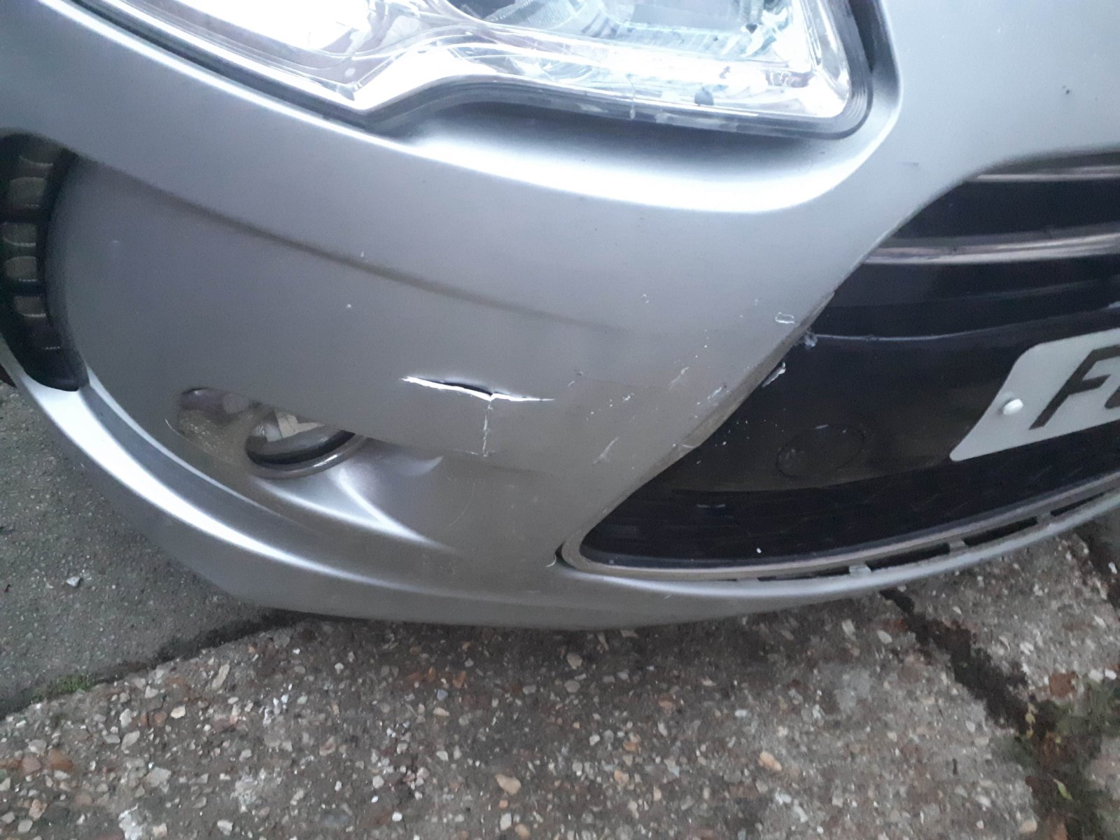

Hi I have a citroen ds3 cabrio with the myway audio system fited. I had a bump in it and had it in the garage for repair. On collection of my vehicle the screen is only showing coloured lines no display and the mechanic doesn't know what the problem is as he never touched it. The air con was replaced so not sure if that had anything to do with it. Also in the last week my stop light and temperature light has been coming on and more so if the aircon button is pressed. Any advice would be much appreciated.

You mentioned 'a bump', but how severe was the damage and where was the impact? If the car has been officially repaired by the approved insurance repairer - then hand it back and say it's not right.

Thanks for your reply. The vehicle damage was front bumper damage and bonnet realignment, nothing major. The headlights were replaced and new air con condenser. The insurance deemed it cat n write off but I had only purchased previous year at a lot higher price than they valued it at so I had the repairs done by my local garage who deals with all my repairs. It's at the garage today and they are trying a temperature sensor. Other than that no codes have come up. Just really wanted advice 're screen as this was never touched by my mechanic.
