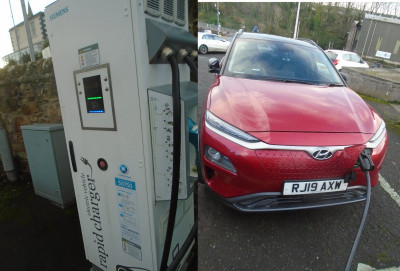

Did venture into Scotland today, and turned up here at Eyemouth, intending to phone chargeyourcar and get them to initiate a charging session, and possibly link my existing BP Chargemaster Polar Plus card so I could use it at other sites they manage on behalf of Chargeplace Scotland.
But one of these was on charge and not back for 3/4 an hour
Eyemouth Charging Station<br />NF Own Work
NF Own Work
Plan B....drove up to GrantsHouse about 8 miles iup the A1....couldnt find the charger location so abandoned the Charge up in Scotland process and went back to Berwick :-D
Conclusion...not going to bother faffing about for the sake of £20 going to get a chargeplace scotland card if we can. We would have spent more that on Petrol in one trip up to visit family in the Edinburgh Area in the old days!

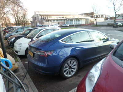

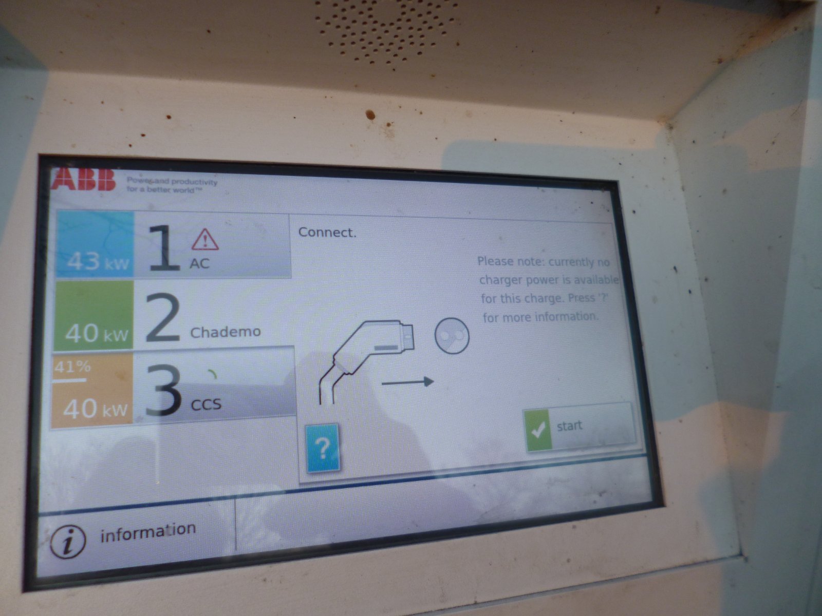

Well this particular charging point can't cope with a Tesla Model 3 being pugged in and the chademo being used by yours truly.
Please note currently no charger power is available for this charge

Most (possibly all) dual/triple head rapid chargers cannot charge both CCS and Chademo at the same time, as they are both DC and there is only one AC to DC converter in the unit.
Some rapid chargers can charge AC and one DC (either CCS or Chademo) at the same time - so if you see a Zoe plugged into the AC cable you've got a chance of being able to use Chademo at the same time, and I have charged my Ion on Chademo beside a Zoe on the same charger using AC a few times now.
It depends on the make of rapid charger, the configuration of the charger and how much power is available to the unit, and it might result in the other car being throttled down in speed a bit if the power supply to the site can't support both operating at full speed simultaneously.
Some Tesla Model S/X owners plug into the AC side of rapid chargers either through ignorance or due to not having the Chademo adaptor, (giving them only 11kW instead of 43kW) so if you see a Tesla model S or X at a Rapid charger and it is using the AC connector you also have a chance of being able to use the Chademo connector at the same time.
You're unlikely to see a Model 3 owner using the AC connector though - while it will fit and work (at only 11kW) they should be using the CCS connector and would have to be fairly ignorant of the CCS socket on the car not to be using it...

Thanks Simon. We had two alternatives on the way home so didnt hang around for the blue Tesla to finish. When we arrived there were 2 model 3's parked next to each other, the blue one was waiting for the white to finish and leapt on straight away. The Blue was on the CCS which showed 40% charge so we may have been some time.

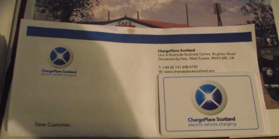

Well they said 3 to 5 days, landed on the mat this morning after ordering it on-line Thursday night. Chargeplace Scotland card all the way from Shoreham by the Sea West Sussex :-D I mean its like Scott's Porridge Porage Oats being owned by Pepsico :-D

That Shoreham address is (or was) the Advanced Technical Development Centre for BP Chargemaster. I used to drive past the site every day.

bobins wrote: 14 Dec 2019, 18:06 That Shoreham address is (or was) the Advanced Technical Development Centre for BP Chargemaster. I used to drive past the site every day.
I think BP Chargemaster own/oversee the lot, CYC (Charge Your Car) and their services for ChargePlaceScotland, and Polar Plus.

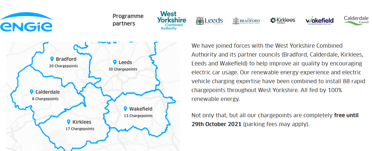

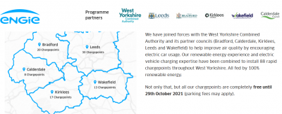

I was a bit ignorant of the developments in Charging Infrastructure in West Yorkshire on our maiden voyage the other week. Engie (roughly 1/4 owned by the French Government) and the West Yorkshire Councils are to provide 88 new rapid charging installations, a handful of which are already operational.

I see on the prose there that you will get free electricity although you may have to pay for parking!! Surely that is a loophole in the free charge offer, if they are free to adjust parking fees in collaboration with the parking authority. Call me a cynic but I just get the feeling that it won't be as free as you might think given that you wouldn't be parking there at all if you didn't need a charge! However it is also designed to ramp up EV ownership which is not a bad thing but I have to wonder what the charges will be once they have a significant number of users? :)
