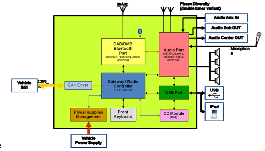

As for the specs - not too much information:
Manufactured by: Continental
Radio Controller: Texas Instrument TMS 470DSP:
DSP: NXP Dirana2 SAF 7730
Bluetooth & DAB Host: Analog Device BF525
Bluetooth controller: CSR BlueCoreC6 Rom
Operating Temp: -20°C to +70°C
System consists of Hardware modules with embedded software
System is composed of 4 main modules:
  • Radio Controller is master module of the system, it is called Host; It drives AM/FM tuner for analogue radio features
  • Audio processor based on a car Digital Signal Processor; also to provide audio settings and ambiance
  • Multimedia controller for CD, USB and iPod features;
    Bluetooth Core is included in ADI BF 525 processor connected to Host processor, it is called CoDSP. It includes BT stack and profiles (provided by a 3 party supplier iAnywhere). It is connected to a HCI controller to provide BT connectivity features
  • DAB Core (optional) is also included in ADI BF 525 processor. It is connected to DAB tuner to provide radio digital features.
Click to zoom

Wow, that's a lot of info, thanks Marc.
I think I'll try and make playlists, see if it speeds up the indexing.
Without looking up the datasheets of those components, is the output power known, I think I read somewhere it was around 4x40W but this seems a bit optimistic to me.
Is it possible to update the firmware if there is a newer version available?

I think they were 4 x 23W Elis. The unit has a Class D Amplifier (Pulse Width Modulation) I believe.
No firmware updates available on-line for these units - it's only the telematics units that have firmware updates - which are usually released to support the later mapping updates - although it does provide them with opportunities to squash some bugs / make some improvements.
