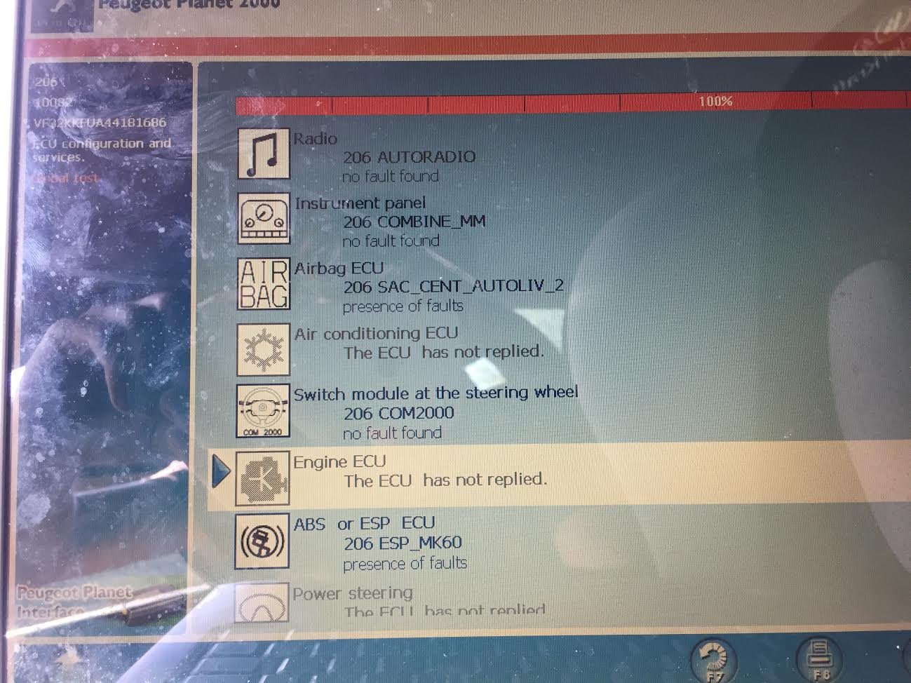

All seem to be ok, so let's start the engine. And there goes the 3000 rpm and no more. I connected my PP2000 and what a surprise while the global test went crazy - all components from top to bottom "ecu not replied" starting from bsi to the convertible roof (first thing i ever saw it on the list while global test). The only exception was the engine what did show some fault. The exact ones like i had in the past refered to the antipolution fault / oxygene sensor so that wasn't anything new.

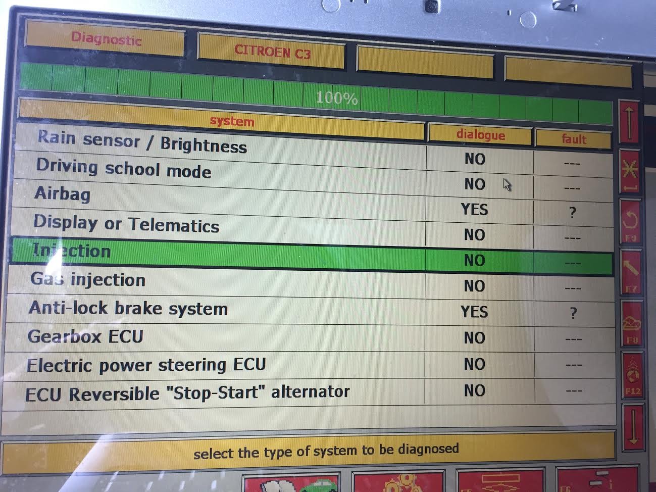

I startet of with trying to download the injection ecu (hope i wrote it correctly) but pp2000 desn't let me when i choose neither KFU nor any other injection unit. Nothing actually worked since i tried to go into any other compontents like bsi or event the radio. Ok, it Peugeot, that's what i could expect, so I managed to gift myself and my laptop a Lexia 3 and connect the old girl as Citroen C3, it found my VIN, I've inserted the code from the door, all fine. I went with the global again and actually it found some components, but injection? INJECTION / dialogue: NO / fault: ?. Stange as Lexia have found all things like radio, airbags and stuff. Tried with downloading the injection. "No dialogue with Ecu during initialisation blah blah blah".

Connected my PP2000 again and this time it did find the compotents like BSI and so go on. BUT NOT THE ENGINE ECU. The exact opposite and I didn't even do anything as it did not even let me go into the config. Some of the things are missing on the global list, don't remember what else was there.
Rpm still max at 3000, still can't configure the injection nor any of the KFU related stuff.
