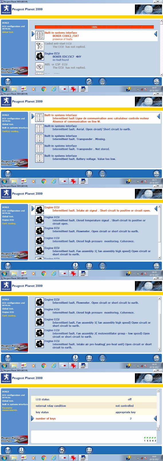

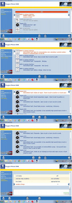

chaps, can anyone hazard a guess at the fault below? (it has been recorded in the BSI)
Intermittent fault:
ligne de communication avec calculateur controle motuer
Absence of communication on line W
is it : A broken or bad wire/connector somewhere between BSI and something else.. what is Line W for I wonder..
going to study a diagram now
Intermittent fault:

If that's an F015 code then it will likely be: Absence of communication with the engine management ECU.
As it is intermittent fault, it was probably associated and recorded when you had the issues with the dead battery and couldn't start it - hence lack of communication with the injection ECU John.

Re: Boxer II camper van - DIAG
thanks Marc..
taking my first look at Sedre now.. quite cool isn't it?
I couldn't see a code number for some reason in PP, could be user error..
anyway, today I went to dealers and got the 2 security keycard codes, one 'electric' and one 'mechanical'.. In PP I entered the electric code, accessed the BSI and removed the old faults.
She still wont start but the battery was getting flat so it's back home for a recharge.. after not starting the line W message came (back) up - which makes sense with what you say Marc.. I did see the immobiliser light flashing whilst she was turning over, but that could also maybe be because of the battery condition.
The immobilser status is again 'unlocked' in PP
I couldn't work out how to bypass the immob to prove if that was or wasn't the fault. The instructions are to turn IGn on, hold accelerator down until a multi function ?light/display goes out, then the immob light should flash I think, then I can enter code using accel pedal.. but I never saw the flashing light..
I guess that if I did have problems with the keys/immobiliser, it wouldn't be unlocked..
will revisit with a charged battery in next couple of days, and some easy start, and see what's what.
Cheers,
J
Cheers,
J
