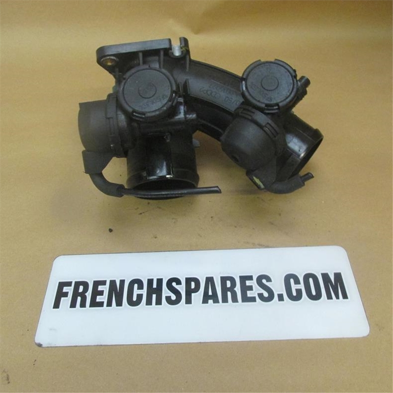

That's really interesting, I am curious about the really odd looking 'double doser' that some RHR engines have like yours:
My C5 also has the RHR engine but a single doser without the inter cooler bypass for some reason.
So was it the case that both of your doser valves were stuck shut with the loss of vacuum and by default the dosers spring shut?

Don't think so EDC5. I'd need to take a look, but its a couple of years since i changed the doser assembly, and I believe one is sprung open and one sprung closed from memory. Makes sense really as a default behaviour, and I suspect the sprung open one is the bypass ? Back then I changed the doser unit as the actuator on the flap had died, and the flap was 'flapping' free, causing pretty crap mpg. IIRC the vac actuator pulls on a rack which turns a pinion on the flap shaft.
This time, the failed valve obviously was not driving the doser flap to where it needed to go, but the mpg was fine and the car drove normally at low revs. From that, I guess that the failed valve would have been used to pull the bypass flap shut against the spring, and without the valve doing that, some air whistled up the bypass uncooled. I'll try to find time at the w/e to double check which valve is connected to which flap.

That's very interesting, I bought a spare Doser (single port) for my C5 and cleaned it up checking that everything was working, I then swapped it with the one that was on my car... Good job I did too as it was filthy, lots of tar like crud around the manifold air temp sensor, but especially opposite the EGR inlet pipe . I haven't noticed any improvement in performance by changing it with a clean one however.
Just a note, the butterfly valve is actuated by a vacuum diaphragm, but is this a 'All or nothing' type setup? or can the vacuum be varied to partially open the throttle? Same question for the variable geometry turbo that is vacuum controlled... can it be varied or is it just on or off?
From what I gather, the secondary bypass doser was used on some RHR engines (but not all) to bypass the intercooler for DPF regen.
This video explains the dual doser thing.

Just checked the unit I took off a while ago. The intercooler flap is sprung open and could be closed by an actuator. The bypass route flap is sprung closed and weighted at the bottom too.
Neither offers any feedback, so these are either open or closed devices, no partial settings.
Many parts look common between the two actuators, but the rack that turns the pinion on the damaged bypass flap shaft is missing some teeth, so not driving properly, allowing the bypass flap to float free and jam the rack.
Tim
Tim
