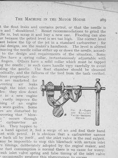

Ouch! Sounds like a machine gun is going beserk in there John..
Bent valve(s) for sure but at least it runs well so fixable for sure :D It takes very little bend in a valve stem to make a real racket.
You need one of these...
This was taken from an old 1920s motorcycle book I have...
She looks a beautiful car John and in a great colour too. I just adore the shape of the 406 Coupe :P
