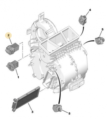

There is another possibility of course - not all these issues are caused by the engine fusebox. It could also be the blower motor control module that has failed.Valleriani wrote: ↑22 Oct 2018, 14:08 I can get the vin later at the moment I don't have the car. I'll PM you it really quick. Would it be overly difficult to do?
The ac fan doesn't work at all at any speed. The screen to change the temp and how fast the ac blows still exists, but no air actually comes out. It's seems to be something to do with a problem with the fuse box though and seems to be an issue. Fuse/etcs are all fine, replaced to test. Works fine with that hack above.
Once I have your VIN I will show you the relevant part.

Ok, so C4 5 DOOR SALOON 1.6 i 16v 110 (TU5JP4) Manual gearbox 5
They are available on ebay for (UK) £24
https://www.ebay.co.uk/itm/SmartSense-H ... 463533077f
Here's the Heater Detail - the Heater Motor Control Module is item number 2. Part 6441S7 £135.60 From Citroen |

Ah nice OK. This could cause what I am experiencing then? (I.E. Going around it with the splice it so it actually works?) Reason why I am asking is because I heard if the this fails it normally only works at highest speed and not just lower speeds, where mine won't work at all unless I use that splice hack above.

It's just another possibility for you to consider - some of these can work on full speed or nothing, others nothing at all - so hard to tell. But I would be wary of bypassing the fusebox to be honest.
