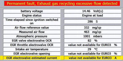

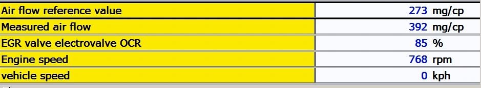

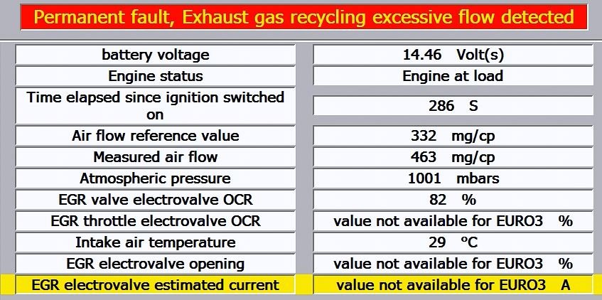

Here's some more
...as I had cause to go out yet again, this time I cleared the fault before recording data.
At idle, just after starting.
Eventually the EGR OCR flatlined again at 5% so I pulled over and checked for the fault data.
C3 P0402 EGR Excessive Flow

Re: C3 P0402 EGR Excessive Flow
I think Stewart and wheeler called it right from the off
The data shows more air is passing the MAF than calculated.
What's more, the ECU is commanding 85% EGR OCR (until it gives up and flags the fault), which I believe is the absolute maximum it can ask for.
Then, with the EGR taken out of the calculations, the Reference and Measured values perfectly match!
Yes, it generally drives ok, pulls well for the little engine I guess, though I've little to compare it to.
I intend to give the MAF a good clean as it's so easily accesible so yes, can disconnect the plug too but not sure if this existing fault would only confuse the matter at this point?
