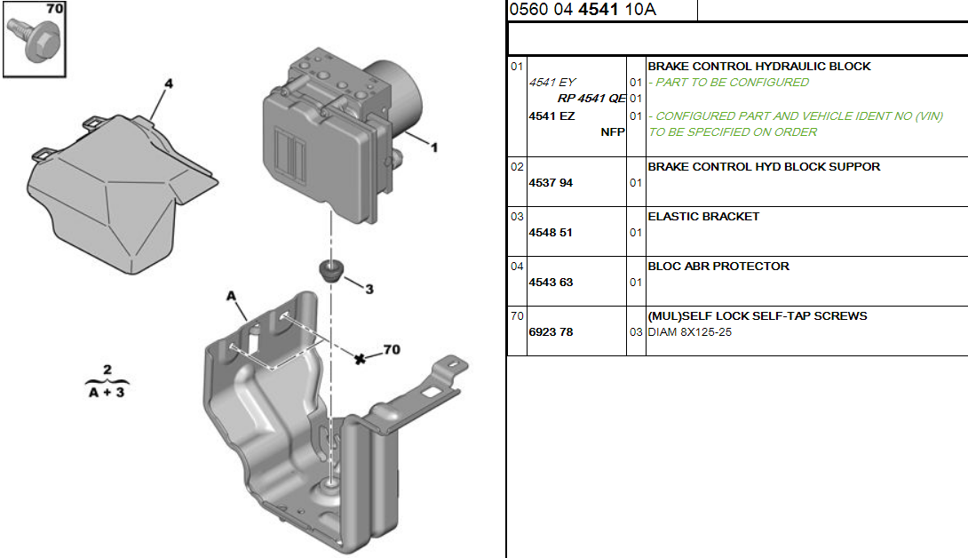

Ok, so none of those are the correct ones for your car.
Click to Zoom
Your original Part for the Hydraulic Block was 4541EY; this was later superseded with a replacement part, no: 4541QE |
Re: Abs esp module part number
I am trying other things first
So it's the complete block and ecu
Those other parts where just the ecu module
So if needed I need the complete pump valve block and ecu in one unit
Cheers for all your help
Yes on this model it is a combined unit, no separate parts. If you are not getting any dialogue with the ABS / ESP ECU, this can be down to the VCI and Diagbox version you are using. What version of Diagbox are you on? 7.57 should be fine for your needs. There are also corrections made with later software versions that prevent communication with the additive ECU , so don't discount this. If you have the version of Diagbox (top right corner) I should be able to see if these were corrected.
