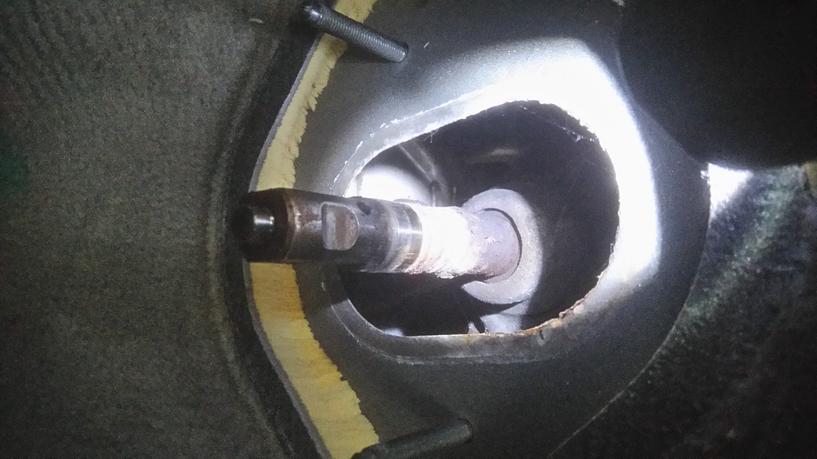

I've managed to gain access to mine. Although rusty it appears dry as a bone so I have covered it in grease and hopefully that will prevent it failing
First time I've posted pictures so hopefully they have attached ok.
Bandit
Bandit

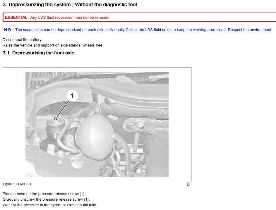

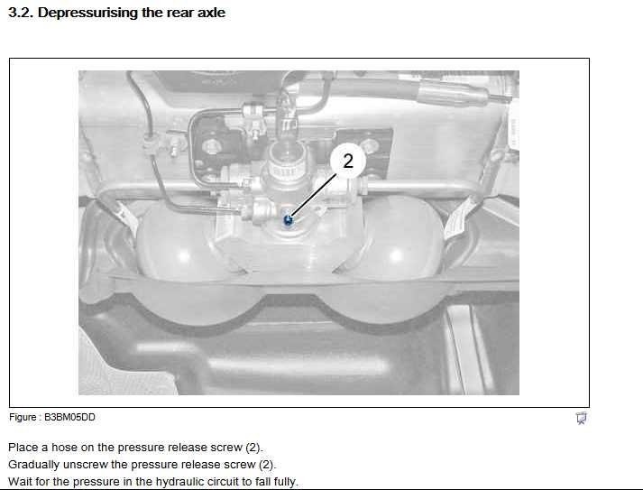

Well here's an update, I can't even get started diagbox and car are not communicating.
It works first time but thereafter no green comm's on laptop.
Also it's going into eco mode within 15 mins which I can't understand why. New battery with 14 - 15 v showing on multi meter.
So this is a cry for help.
Can anyone who lives reasonably close come and depressurise the system for me ?
or Is there a way to do the rack without depressurising or a manual way ?
I was hoping to have it done this weekend but it looks like a non start until this is sorted out first.

It's possible to manually depressurise the system. I'd need to look it up, but it's not difficult.
Someone - possibly me - will be along shortly with the instructions........

Bobbins,
Brilliant, at least I can start the work now.
Will get back with the result and any tips whilst doing the repair for future reference.
