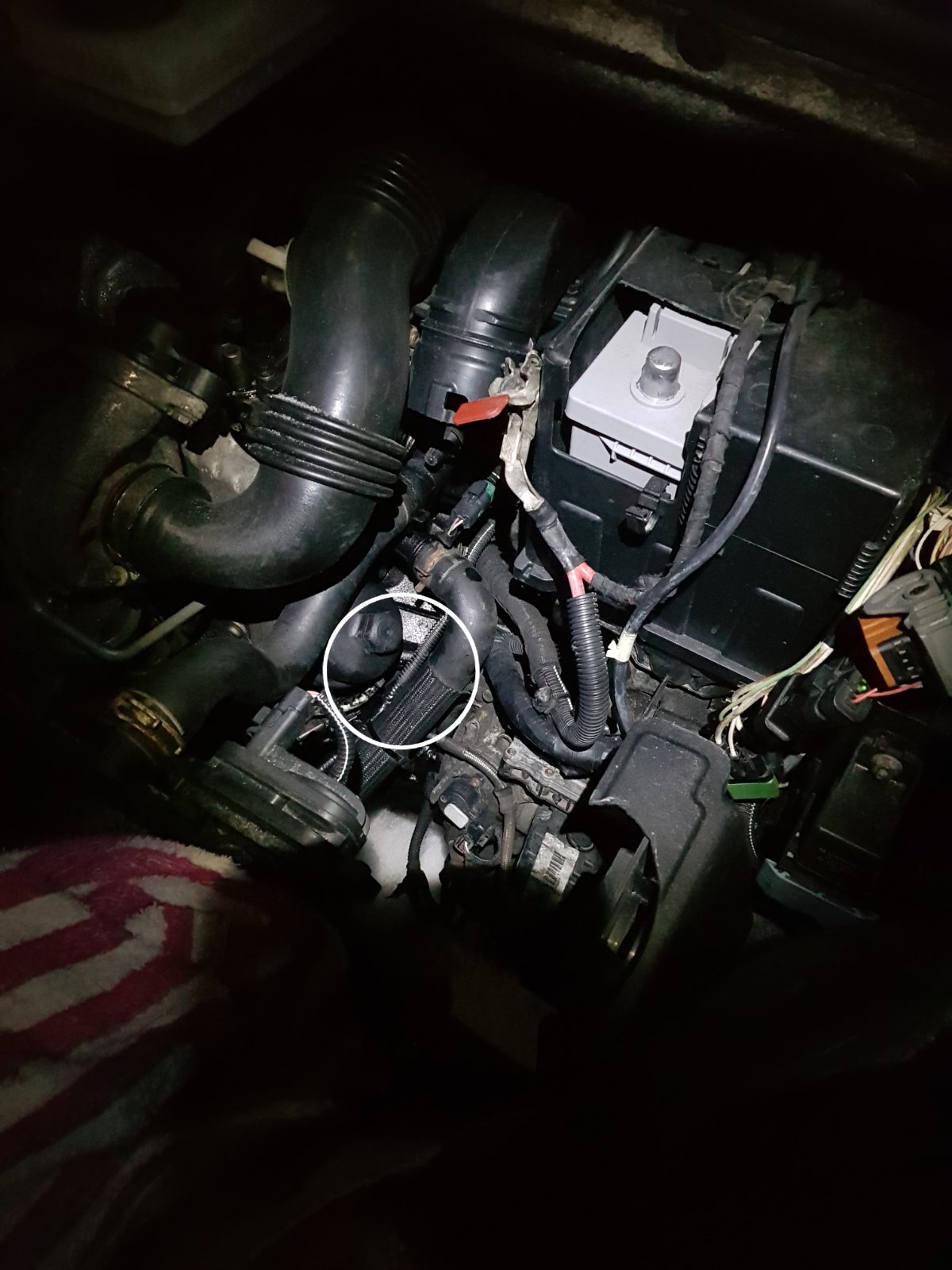

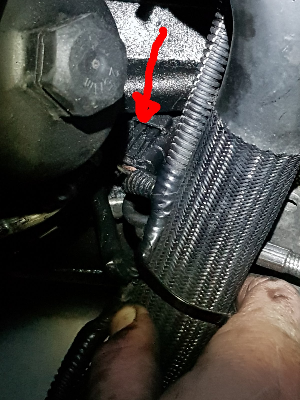

Hi, there is a connector that I cannot for the life of me unplug in my Citroen Grand C4 Picasso 2006.
Can anybody tell me how I can get it out? Do I have to push a plastic part? See this link for what connector I am talking about, it is just under the oil filter cup above a pipe of some sort going into the block. Here are two pictures of the connector I am talking about.
Overview, connector in white circle:
Close up:
The reason I want to get it out is because there have been spilled oil all around it and I have a "Gearbox faulty" error showing randomly. And based on this video it makes sense to clean this plug:
Oh, and by the way, does anybody know what this plug does/ goes into? Any guidance on this is highly appreciated!

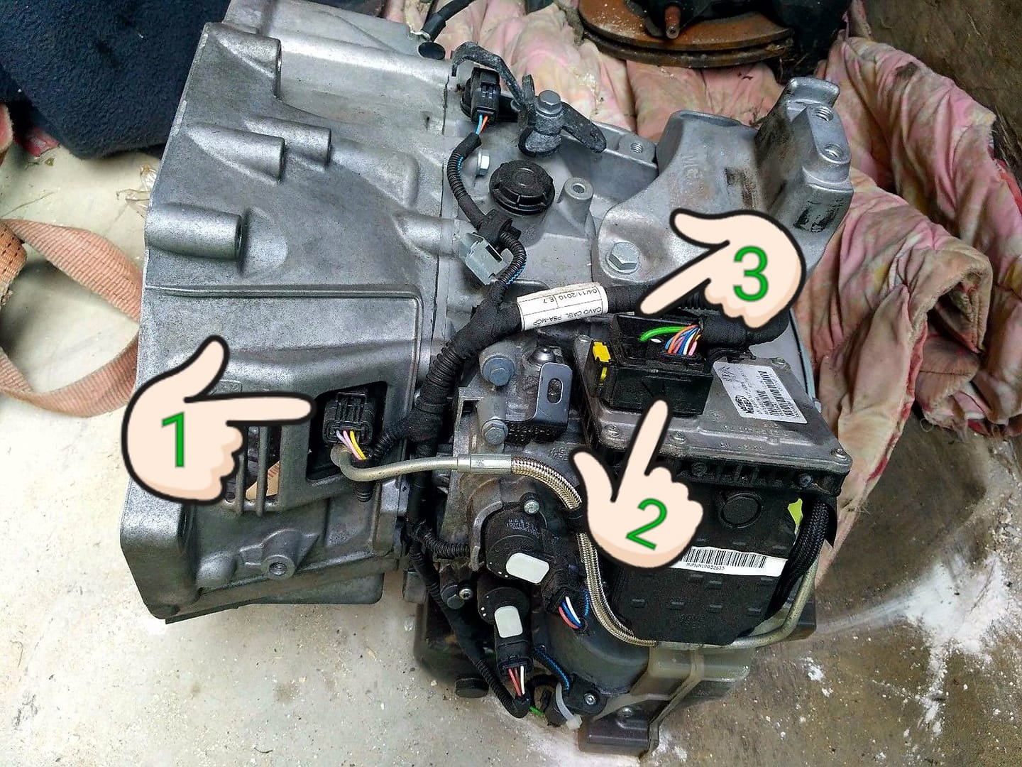

I also need to take off the two connectors going into the gearbox ECU.... again, how do I get these off without breaking anything?

Should be that you press either the front or rear of the clip you can see in the middle/top of the plug and pull it!

I will have another go later today with a screwdriver and see if I can get it out. Please see the attached illustration to see the connectors I need to get off. On the ECU multiplugs, is it an arm that needs to be flipped over to get it off?

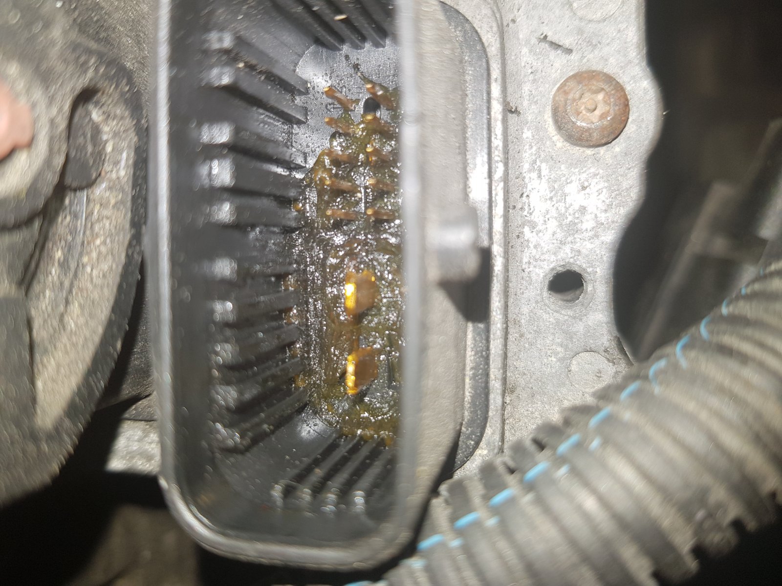

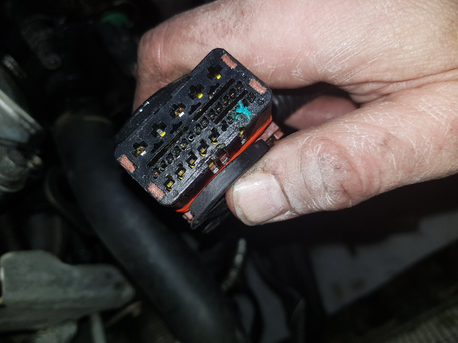

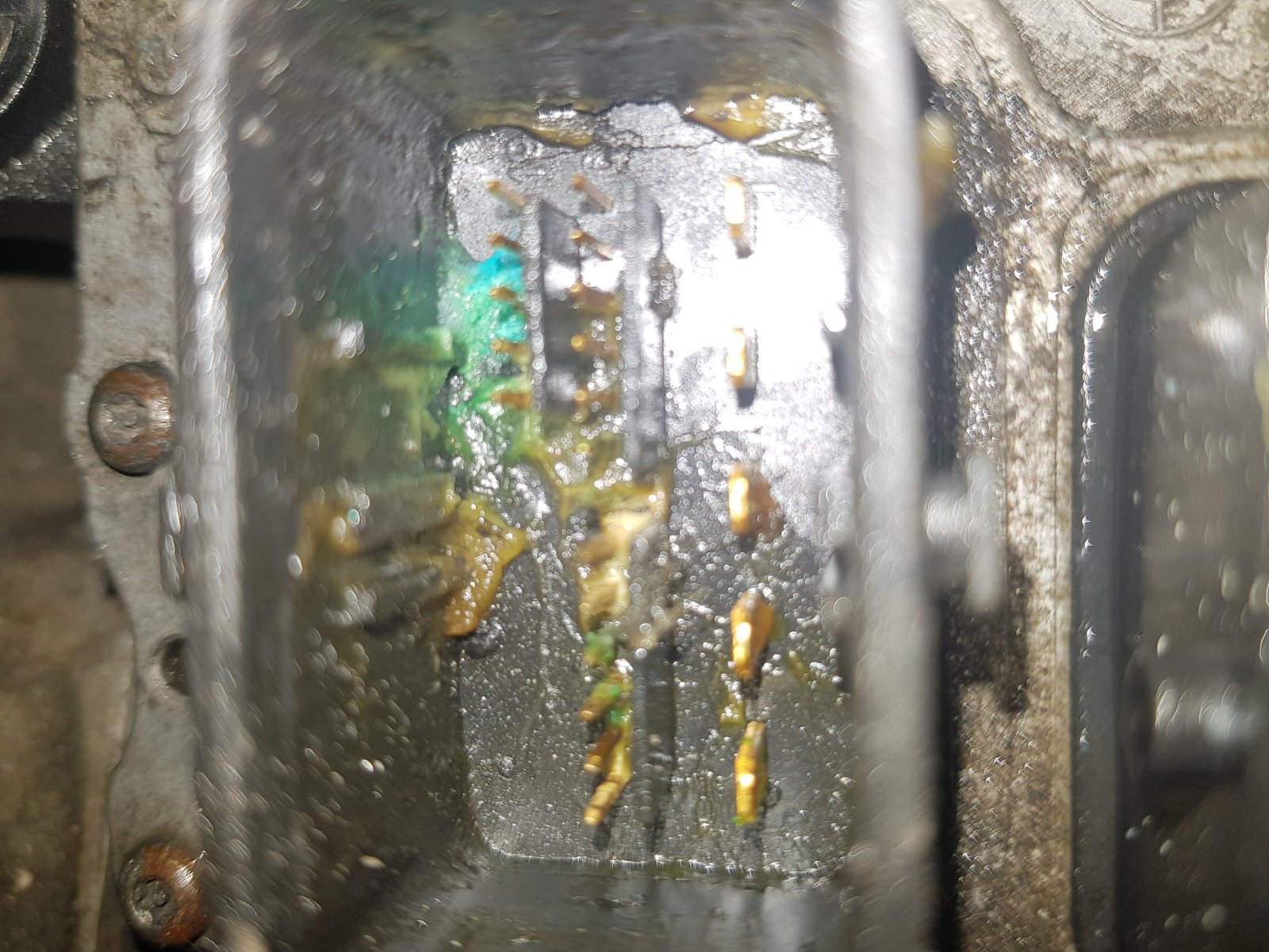

Update:
• Cleaned the three connectors last night. They were full of both grease and corrosion.
