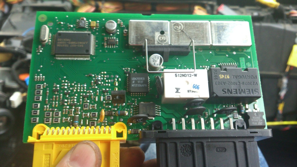

Re: Xantia - Central locking ECU questions
Hi
I removed today the after market central locking ECU and connected the original one. Then I programmed a key that I bought out of eBay and now the car locking system is revert to the original state. As Jim said the little silver box is the airbag ECU
Thanks
Excellent

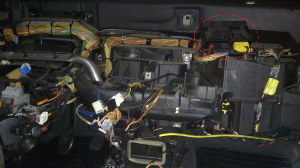

I think is too late but the central locking ECU for mk2 is under dashboard after de glovebox. The unit also contains the circuit for interior lights, temporizator and dimming.
Otherwise known as the CPH...
