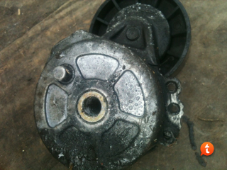

Fitted new tensioners yesterday - auto spring and manual eccentric. The old auto tensioner was well shot away. And, a new aux belt.
Better, it won't jump grooves, metallic clicking on acceleration still persists and squeaking may be worse at idle. Definitely not over- tensioned.
I suspect everything! The noise seems to travel around.
I tried a little spray lube on remaining pulley shafts, but didn't help.
Due probably to the alternator or LHM pump pulleys. The alternator is prime suspect.
When I had the wheel off and belt running, it even sounded like from the crank pulley, which though had no play by hand (as with all pulleys), it seems to have some very slight wobble when running - but perhaps this is normal with their dampening function and rubber sandwich.
I think the metallic click spells alternator. I'm largely guessing, and telling myself it's reason I'm employing.

Here's a photo if the auto tensioner on an hdi.
There are two holes for pinning. It's the first one that is pinned (least tension) when you buy a replacement: don't remove the pin until the tensioner is fitted and belt in place - otherwise you risk injury, it is said.
IDEA: I'm thinking now, that the squeal is the HP pump. It'd be good to have a few lengths of short belt to isolate the pump and alternator, alternatively. I wonder if the alternator could be isolated, probably not, given position of auto tensioner; I reckon you could miss it out though, along with AC.
