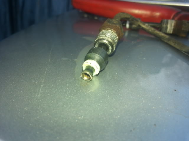

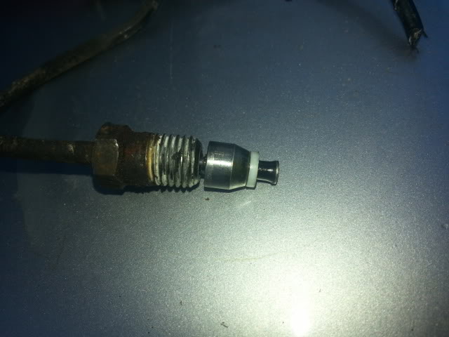

A member on here found that there was a a small run of different pipe connection on the NON Hydractive Cars from 1999 to 2000 and then at the end they reverted back to the Citroen Normal Flare..
Trumpet Flare, nylon washer, and the larger spacer! These were from a V reg LX. These were fitted from around V reg to X reg cars only!!
NEVER seen them before, and I think IF I owned a car with this setup, Id sooner change the rear struts to the standard ones and swap the front tops when the time came.
This style is NOT fitted to T Reg models..
