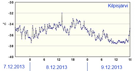

Edit: Off topic. Cold is a rather relative concept and cold can be even colder
This is last 3 days temperature readings in Finnish Lapland area where it reached year 2013
minimum record reading -37.4 degrees Celsius
