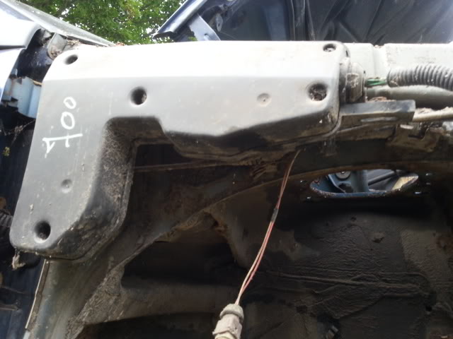

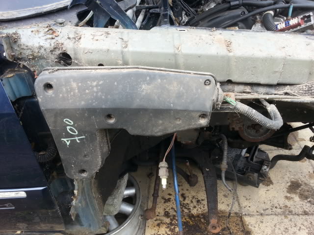

.... what is this Back Box hidden behind the drivers wing with sealed wires connection going to it???
I have rescued it and the COMPLETE full harness right from the massive connector in the scuttle to the fuse box etc...
Just wondered what it was.. Ive taken a fair few Xantias apart, S2's aswell, but NEVER seen it before..

Thats a f kin big relay lol... the cruise ecu is under the drivers seat.. its a vac type system like the xm.. but ive never seen this on an xm..

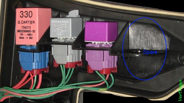

Edit: I checked from my old pics. There are 3 relays,
Big orange, small gray, and small purple color cases.

Re: S1 V6'ers, tell me then...
and this was from mine, a 2.0i 16V '98, MK2.
It seems that there are different configurations. I hope this would help someone in future
Edit: It was a LHD car and this box was on the left side of the car.
