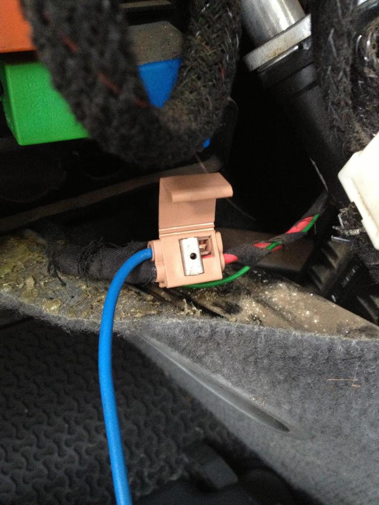

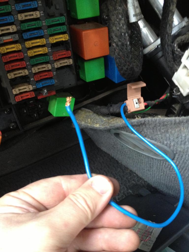

After taking the dashboards apart and the heater control unit out (old basic slider job, no climate controlling electric gubbins here) i traced the sliders tracks and bridged the pins in the supply plug to try and achieve full power.... nothing...
looking at the fusebox someone has shoved a spade in to socket 3, then scothlocked to thick 12v supply wire, as seen in the pics... where i cut the wire a fuse had been fitted, 30amp, which had completely boiled in half, housing and all!!! i tried reinstating the blue wire, sans fuse, to rule out a motor fault and point the finger at the speed controller, but nothing... stone dead. Ive checked the scuttle drain, thats clear...
oh, one other symptom is that the lower dash was badly rebuilt by the previous owner and whenever i changed gear i could occasionally boost the blower speed!!!
here are a couple of pics....
Is this just an atrocious 12v bypass? or is something more sinister afoot?

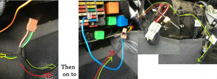

Re: Synergie Blower motor cowboyed, unusual, please help,
Hello, again.
Sorry for the very crude image, but I thought it might inspire someone to try and hell me through my blower woes...
My Blower seems less complex than the Xantia variants, with only having 3 wires into the brown plug.
I removed the 30a fuse from the engine bay fusebox and STILL the motor ran, obviously recieving a low power feed from the blue wire that has been spliced in to the RED wire and crudely shoved into slot 3 of the fusebox.
If anyone could at least help me identify why the motor, that runs on slow speed with the blower fuse and the speed switch removed stops, when the speed switch is connected, then i would be very greatful.
My highly unneducated guess is that the RED wire, which appears to be connected at the plug to a white wire, comes from the fusebox and supplies the motor with 12v+
The thin GREEN wire comes from the switch unit and provides the OPPOSING 12v which regulates the motor speed (12v = blower off, 0.9v = almost full speed)
and the GREEN+YELLOW wire provides the earthing.
Is it possible that at any given speed, when connected, the GREEN switch wire is providing more voltage than the motor is recieving from the crude BLUE feed from the fusebox, thus stalling the motor???
yours with crossed fingers...
