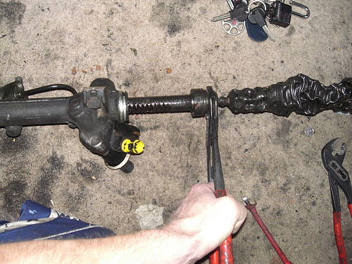

The play is on the actual balljoint - I wouldn't call it a bush! That's a
whole different set up on different Citroen models.
Xantia track rod inner and balljoint.
You can get the steering rack out through the driver's wheelarch but the
lower wishbone needs to be removed. I did this last year and it wasn't
so bas if i'd fitted the right replacement rack on - I found out the hard
way the only difference in the pinion hydraulic pipe unions - the pinion
was leaking very badly on the original. Ended up doing the off/on job
twice pretty much as it was late in the day when the difference was
noticed. Silly thing was the racks were all off the same registered age
Xantiae but this could still span well over a year I suppose.

Paul, looking at Andrews post with pic it now makes sense, the play is in the ball joint!! Nothing like sharing information, Thanks

My mind is becoming shot to hell these days and the adage of forgetting
more thsn I know probably rings true but I do seem to recall now I used
a decent pipe wrench/pair of stilsons many moons ago to grip the inner joint.
Helps of course to wind the lock out on the side you're busy with to give
yourself more access around the joint and give maximum leverage of the
stilsons.
Andrew

Thats the Way Andrew... you had me thinking then I was giving incorrect advice... but its exactly how I swapped my XM ones...

I thought so Paul. It must be the Cx I'm thinking about with the peening.
Damned chunky bushed joints which tend to be hopeless and easily
woern too. :(
Should this inner swivel in fact be the cause of the shudder and play,
I wonder how many garages would happily have relieved a large chunk of
money in parts and labour to fit a new replacement rack. Come to that,
how many would just swap the track rods/ends and charge for a full rack
swap... :shock:
Call me cynical if you want, but this is the stuff of the horror stories found
by undercover Trading Standards guys.
Andrew

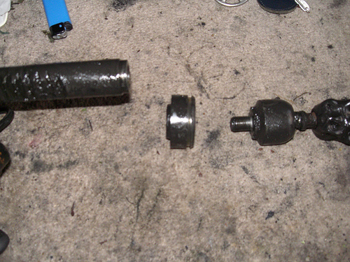

a picture speaks...............
CIMG2309 by Deanxm, on Flickr
CIMG2308 by Deanxm, on Flickr
not the n/s butthe joint is the same, it just has a small rubber boot over it that needs levering off first, its held on the same way pushfit plastic plumbing fittings grip the pipe.
D

For future reference there IS a nylon bush in the end of the rack housing and it can wear out but only if there is not enough grease in the rack, for example when the boot has split and been washed out inside and full of muck for example but there are very hardy.
