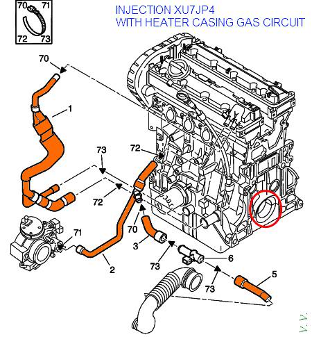

I agree with HDI! Lots of work, with minimum parts costHDI wrote:Get a few quotes for the work, some garages deliberately quote high on jobs they don't really want to do...
Ref here is something that you can do if the weather conditions are suitable.
Clean those "breather pipes seen in the pic.
I clean them before winter season with brake cleaner.
You can use normal hose clamps for securing.
I have marked the hoses with some color and marked also the crank shaft oil seal location.
Number 6 is the electric heater for the pipe, I guess you have also one or two of them
I've tried that in the past with some success, worth a go.
