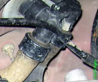

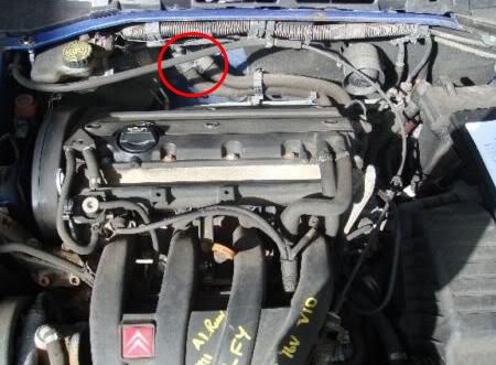

I have found this picture from ebay, 1.8 16V Engine LFY XU7JP4Gingerposer wrote:... still can't find the bleed point near the bulkhead in your first picture,VV. ...
This picture is from a RHD like yours. You should see the plastic cap in the red circle
Edit: and this is from a Xsara where bleed cap is designed vertically.

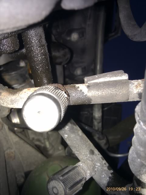

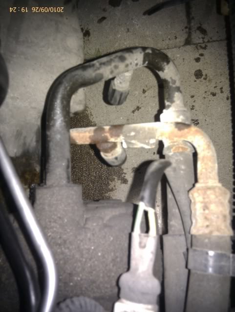

Some limited progress with the bleeding radiator!
VertVega, many thanks for that last photo - it is indeed in that location, just knowing where to look made it so easy.
However, when I open that bleed screw, nothing comes out.
When I opened the bleed screw on the thermostat, a little air came out then water.
When I opened the bleed screw hopefully shown in the two attached pictures, nothing came out but by blowing in the top of the expansion tank I was able to hear air emerging somewhere.
The rad is definitely not leaking water anywhere, nor are any of the attached hoses.
I haven't yet sussed how to edit the pics to circle the screws I opened, but I did try both - I guess by the attached pipework that one is for the AC system.
Any more suggestions?
Last possibly daft question - it's not stated in the book of lies whether the engine should be running while bleeding the system, so I didn't run it. Was this right?
Cheers again,
Ainslie

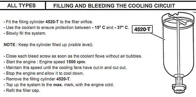

Quick instructions for filling and bleeding cooling circuit.
You can make your own special tool "4520-T" from a 1,5 liters fizzy bottle and a O-ring
PS: In your above pictures those pipes belong to Air conditioning system and it is completely another closed circuit.
AC compressor, low and high pressure lines and their valves are seen.

The last two pictures show your aircon points. Do not attempt to do anything with these , the plastic caps just protect the valves inside though. Refrigerant being ejected onto your bare skin is very very nasty.
Andy.
