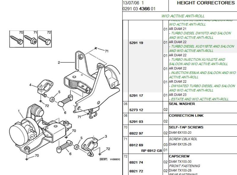

find the part Number for the Suspension adjuster.....(the bit that goes between the lever between the seats & the height adjuster)
I KNOW the lever between the seats & the height adjuster are NOT connected ...(Coz I can see the "LINK" hanging loose under the car)
or better still post an exploded diagram of said linkage (just so I can get it straight in me head!!!)

GREAT!!! ....Thats what I'm after ... THANKS!!!!
(I'm assuming I'm after part No 6) ..Eerrr Am I ???

Seasider, excuse any explanations of the obvious. Looking at the height control valve as a Control System with two inputs:
The dog-bone connector (item 6) provides actual suspension height input from the centre of the anti-roll bar. The spring mechanism and the inherent lethargy and hysteresis of the hydraulic system provides the necessary damping.
The height control lever provides (via the linkage that is flapping in the sea-breeze) the base height reference input.
Logically, the suspension should be stuck at whatever height it was when the connection broke - BUT your whole rear height corrector mechanism is very stiff and probably full of rust and dirt (probably why it failed in the first place!) so as the suspension goes up and down, friction moves the reference point between the two limits.
By reconnecting the dog-bone, you've actually created the problem by providing one of the two system inputs while the other (the 'fixed' reference position) is 'floating'.
To add to the complications, it sounds as though your 'anti-sink' sphere and/or main accumulators, which between them provide a pressure reserve for the hydraulics (brakes and suspension), are getting a bit tired. So the suspension sinks more than it should. But don't worry about that until you've sorted the height control.
It's perfectly normal for the suspension to go up and down a bit when you start up; you've put some load in the car (occupants), the suspension compensates taking fluid and pressure from the accumulators. When you start the engine, the HP takes a little while to bring the system first up to minimum pressure (STOP light on) and then up to within normal operating limits.
Oh, and your not being THICK, it took me a while to get my head round the basics of the Xantias hydraulic system and I'm still struggling with some of the finer points. I've started writing a Guide to Xantia Hydraulics but only the first section, the accumulator, is finished. The definitive The Citroën Technical Guide by Željko Nastasic´ and Gábor Deák Jahn is comprehensive but a bit of a heavy read as it covers various different models and variants.
It won't all work properly until you've freed-off the rear height corrector mechanism and re-connected the control rod, and then bled the rear brakes - common system with the rear suspension, but crud and old fluid get trapped in the dead-end to the calipers, but can get back into the main system to cause trouble.

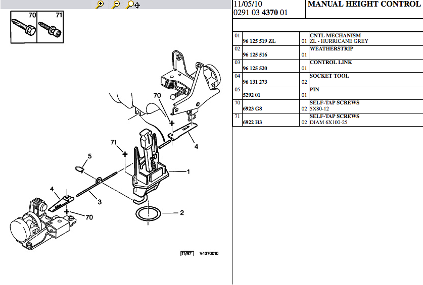

Another helpful picture?
This shows the manual height adjustment lever o the pair of height correctors.
It may be the main longitudinal control rod (item 3) is bent or even fully
disconnected so leaving the rear height corrector (RHS) to fend for itself?
Seen this before where a car has been driven over a kerb etc before fully
lifting up.
Andrew
lifting up.
Andrew

Andrew, That Pic was VERY VERY helpful mate ...(See Below)
the RED circle is where its come loose ...& I have a "Thing" like in the GREEN circle just hanging down.....
SO, I'm assuming we re-connect it ...give it SHED LOADS of WD leave it over nite & things "SHOULD" return to normal ?????.....
As the front doesn't "DO" owt either I assumin that the same thing has come adrift there as well....
I CAN see the rear but the front is "A Female Dog" to "See" .......I'll have to wait until my mate comes off his holidays & get it on his 4 poster to see clearly .....
Either way it don't LOOK like a MAJOR job to fix .....
Unless of course, YOU know different
Keith
Keith
Hi Keith - you got it - setting the lot back up and fine tuning may be faff butThe Seasider wrote:the RED circle is where its come loose ...& I have a "Thing" like in the GREEN circle just hanging down.....
ultimately you probably don't need any new parts, just reconnection of what
you have on the car. The height corrector mechanisms will respond OK to
cleaning and lubricating and should operate freely/smoothly by hand when
the small nylon dogbone is disconnected off the anti roll bar clamp brackets.
Whilst access from a 4 post lift will be safe and easy the wheels need to be
on the floor and the body supported at the desired height so the anti rollbar
clamps are then at the correct positions to then set the selector lever's
adjustment. Not easy!!
At the current time the one thing I wouldn't adjust are the two clamp
brackets on both anti rollbars as there's likely these are still at the factory
setting unless one has corroded and bent or even snapped it's arm off. The
adjustment will be left on items 4 on the main selection rod.
Andrew
