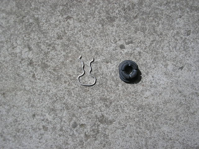

If you have this type of setup on the plastic clip
The rubber sits in the hole in the glass and the "R" clip is pushed over it and that needs a real good pull to get it removed
Just make sure the replacement mechanism comes complete with right retainer
