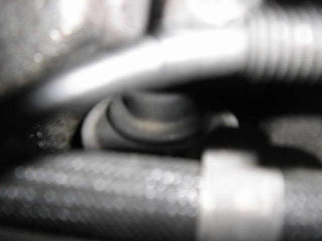

Assume that this is the EGR

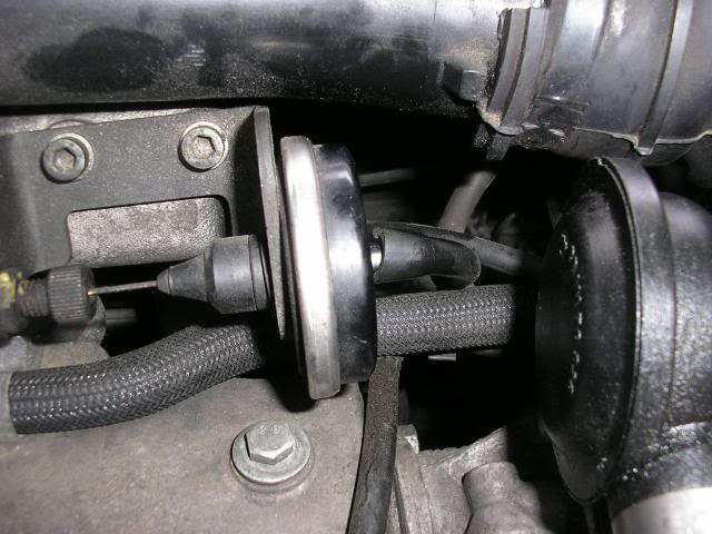

Also would like some feedback on this particular object
Im assuming its to do with the cold start mechanism as it seems to go to the sensor on the bulkhead next to the EGR sensor
The pipe on the end is split as can be seen in the photo is it just a simple case of replacing said pipe as the car is beginning to be a sluggish on start up. starts fine no problems there just needs a little bit more time to settle down

That object is indeed to do with the cold start mechanism. There is suction in the pipe when the car is on warm idle and no suction when the car is on cold idle. That cable and plunger bit is fully relaxed in your picture setting the pump to its default setting of cold idle (around 1050rpm). Its not really worth fixing it as the only real advantage at warm idle (around 850rpm) is that the engine sounds smoother.admiral51 wrote: Also would like some feedback on this particular object

The EGR valve is bolted to the exhaust manifold, and I doubt with the hotish tempertures the manifo0ld gets to you'll get it off...

If you managed to get the EGR off, you'd ALSO need to change or block off the inlet manifold as its connected to that... I happen to have a 1994 inlet with it already blocked off...

Are you sure Mike? Ive had a Xantia that this was never connected, only by misfortune, and there was never an issue with bad idleing..
All those valves have replaced are the Wax type fast idle advance from the older thermostat housings.. Ive removed the EGR from this P plate, and not got the valves connected and it runs a dream, and idles perfectly...

Yes Paul, let me explain:citroenxm wrote:Are you sure Mike?
Without intervention, the bosch pump will run at the fast idle setting.
Once the ECU considers fast idle is no longer needed (ie engine temperature rising), it energises the solenoid/electrovalve. This in turn allows the vacuum to pass onto the "flying saucer" which then pulls on the cable disabling the fast idle and allowing the normal idle to take over.
So my theory is; with the vacuum hose in that condition, I wonder if it's possible it's causing a pulsing vacuum, maybe due to vibration, maybe due to suction or both, which might create an irregular idle but it's only a guess.
I was hopeing to be able to remove it and the manifolds to give them a good clean...seems its not that simple

Then surely it's worth replacing the fast idle vacuum pipe? It just might cure the idle and is a darn sight easier than EGR cleaning.admiral51 wrote:Thanks for all the replies gents
Its usually only when warm/hot.the strange thing is that it appears from the rev counter to actually drop the revs when warmed up but i still get the feeling that the engine is trying to rev a little nothing noticeable on the rev counter just dont feel rightDo you suffer poor idle when cold, hot or both?
I can't see how a dirty EGR would cause anything other than a lack of power. It's the fuel that alters revs. But if you're insistant, I'd be happy to lend a hand.
