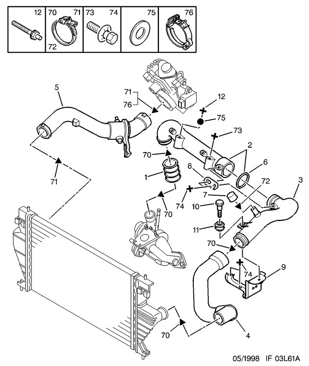

I have a Atmos DV on it, there is no boost what so ever, even if i put a boost gauge on it, its not even going to register lol. no air come from the DV once you release the throttle.
One thing i did notice was a nice Air rushing noise coming from (check this diagram for reference) http://membres.lycos.fr/ci6web/auto/activa/note_72.jpg
the part that isn't numbered, but sits on this picture below the number 4 and the black swoopy arrow. its not numbered in that picture but that's the part that's making the "air rushing" sound i never noticed this before. I've checked all hoses even had the car on 2 post car lift, and doesn't seem to be anything wrong with the turbo from what i can tell.
Aside from taking the turbo off and having a look, i really cant think of what would be causing it.
