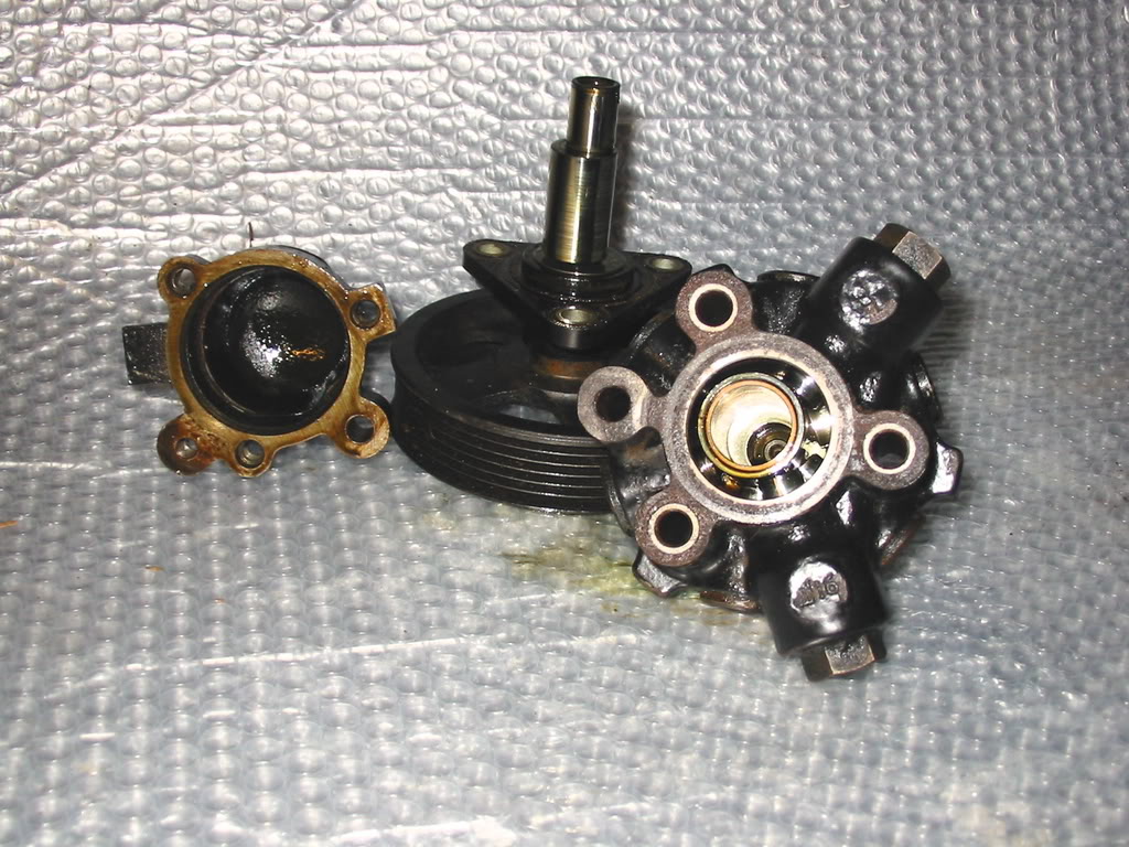

I've had problems with the pump on my "sinker" '93 vintage VSX actually
shearing the through bolts and allowing the end cap bowl to come away
off the pump end which distributes the high pressure fluid. Very messy.
Basically there car had a problem with the 'slug' of high pressure fluid before
the supply circuit was opened!
The problem you have may very well the O ring seals that run through the
pump even if yours hasn't sheared the bolts. If one of these has 'gone' it
will appear like the fluid is running out of one of the pumps orbital 'plugs'.

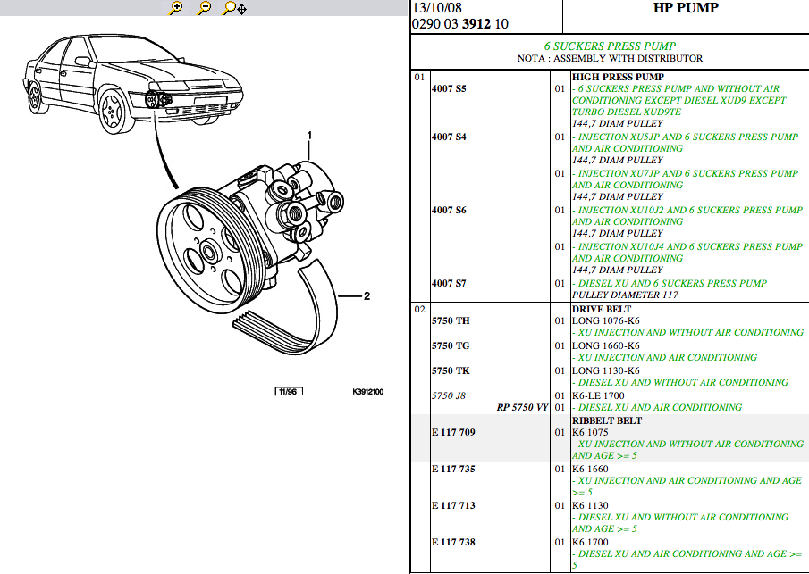

I'm not sure where the original pump thread on this forum is but my
previous posting in this thread does give the rundown of the various
options on the 'sinker' era pumps that have the single inlet/single outlet
design; remember this is different to 90% of all other later Xantias
available!! With that in mind, among the earlier pumps the DIESEL and
TD IS THE ODD MAN OUT with a larger diameter pulley!!
All the other pumps' pulleys barring the diesels have the same smaller
pulley diameter although additional differences aren't detailed.
Don't want to be negative here but the fact is, you need to find the near
unobtainable!! You may be lucky and know a tidy breaker that is thorough!
OK, most of the early cars will be diesel and TD so there's reasonable odds!
I'd certainly concentrate on getting the leaking pump cured before you
adjust or replace anything else as you may even find the spheres respond
well to the correct pressure in the system. I managed to repair my rarer
early pump scavenging the leaky seals off a later pump but the problem
with your pump may be totally different - check out whether the 3 through
bolts are still in good order...
Andrew
