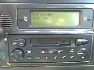

i bought car about a month ago...and first problem with my Xsara VTS '02 1.6 16v
acctually it's a minor probleb but so annoying
it's a display...the bottom half of a display is completely dead, and about 30% of lines on upper half is dead too ( see it on pic )...
is there any way to fix this because in my country is hard to find any Citroen breakers for used parts...
and second problem is with my CD changer...i cant select any cd's??? everythingh is connected and when i put the discs in i can hear a motor running but i cant select anything with SRC button except radio and cassate...does this radio have CD changer support at all

Which country are you in? It might be worth seeing if anyone on ebay breaking a Xsara would be prepared to post a display abroad to you. It will need to be from a VTS or SX to be the right type.
well unforunatly...i am in Serbia and i think that no one would like to send a display to me i found some displays on various ebay sites but i tried earlier to get something for Mondeo on ebay and..no luck

it's just a waste for that display...i cant see any radio station properly...and non of the information...i presume that it have AC info on, clock, automatic lights thing , door open warning, consumption etc. because i have all that and i cant see it

i have teken off the display and everything in there looks ok...but when i took dipley out an cut off it's power and try for some 5 min to fix it when i put it ack there;s a yellow key bulb goes on in the dash??? so i kinda scared not to f#$k something up...so i had put it back!!!
ok guys...can i take this diplay completily off and than try to fix lines myself or carry it to someone who can try to fix this like they fix dead lines on mobile phones or somthing like that...can i take it off without danger to computer or something (i told you that when it was off that yellow key light stayed on for a while on the dash )???!!!

The missing text on the display could be a break in the ribbon cable or more likely a dry / cracked solder joint.
If you take the display to pieces get yourself a good magnifying glass & carefully inspect the solder joints.
If you see any joints that look anything like >>THIS<< that could be your problem, & these will have to be resoldered.
