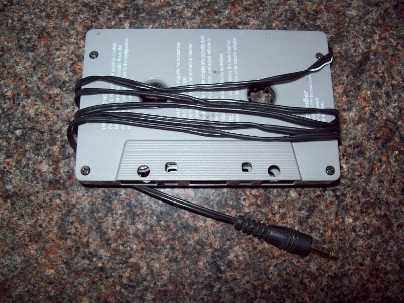

Went down to the scrappers this morning (for a drivers door window regulator) and guess what I found:
I know it's not pretty but it works - problem sorted for no expense whatsoever! :lol:
