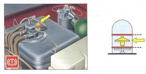

To check the LHM (hydraulic fluid don't use any other kind!) get the engine running and set the car to the highest setting and let it rise up.
There's a clear inspection bulb with a float in it on the LHM resevoir.
On high, the orange float (disc) should be between the two red lines.

Always check the LHM level with the car at MAXIMUM height. Orange 'hat' not coppper ring should be between the 2 lines.
