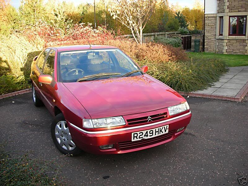

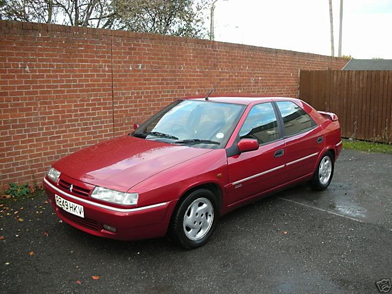

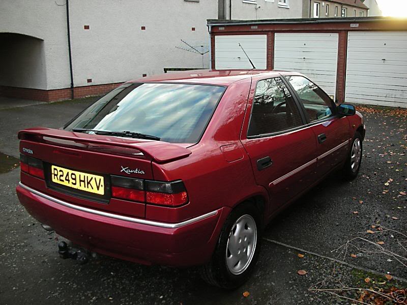

Thanks for the thoughts,
Saves me taking pictures lol.. Yeah the car is in reasonable nick, there's only one minor spot of rust near the rear door, shame about the front right wheel. + a few other cosmetic things that could do with fixing.

that activa looks lovely!!
I am just across the river from you in Langbank!!!
If your ever thinking of selling the car, give me a shout, would love another Activa and it'd be going to a good local home!
