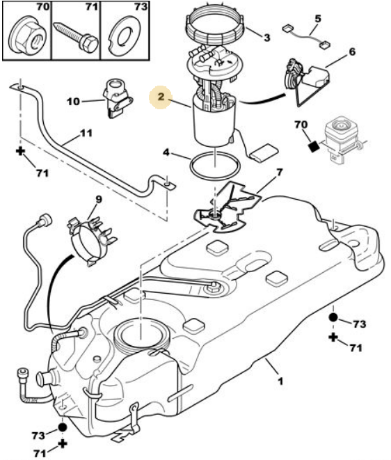

Have you also considered a poor fuel pump?.... Does it start any better if left on a flat spot?

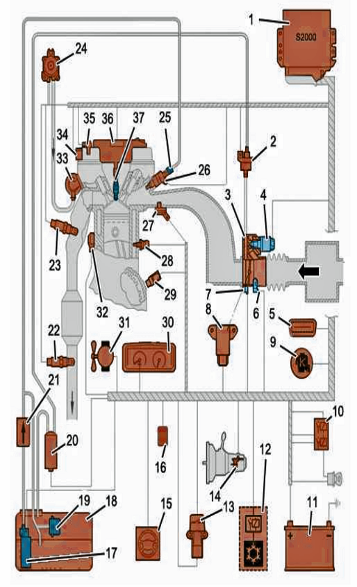

Here's the Starting Circuitry Diagram:
As always, the key to the components is on our Wiki site: Just go to the relevant section - the numbers are in ascending order. 1010 is the starter to get you going

Just thinking ( clutch cable for the pug did'nt arrive ) , the lad has brimmed the tank before now usually to the first auto pump stop, and no fuel leakage has been seen or noticed.
The tank does not have a drain, and I assume the fuel pick up in the tank is in a well just like the mondy, centrally depressed in the tank floor again just like the mondy.
Is the fuel pump centraly mounted in the tank or is it near the front of the tank ?
If its near the front of the tank, and parked on a hill ( half tank of fuel so should be ok ) and has water in it, the water would end up in the fuel rail??
Just a thought.........no fuel seen overflowing as it where so no holes in the fuel pipe to fuel cap, so no water getting in.
I have a new fuel filter to fit this weekend and will carefully inspect for water in it, i will also cut the filter open and inspect the actual filter inside.
Grasping at strws a bit since no trouble codes seen and the mil light stays off once its gone off.
I think the lad fills up at the same places as he did with the mondy and that had no water or crap in the tank.
- x 6963
Re: xsara picasso 03 -plate
Ok, so here's the pump (in tank).
Here's the actual fuel components diagram for you: That double relay you were talking about earlier would seem to be item 10
Click Diagram to enlarge
| Ref | Description | Ref | Description |
| (1) | Engine Management ECU With ’FRIC’ | (20) | Canister Reservoir |
| (2) | Canister Discharge Electrovalve | (21) | Fuel Filter |
| (3) | Throttle Butterfly Housing | (22) | Downstream Oxygen Sensor |
| (4) | Idling Regulation Stepper Motor | (23) | Upstream Oxygen Sensor |
| (5) | Diagnostic Connector | (24) | Air Pump |
| (6) | Inlet Air Temperature Sensor | (25) | Injector Supply Rail |
| (7) | Throttle Housing Heating Element | (26) | Petrol Injectors |
| (8) | Throttle Potentiometer | (27) | Inlet Air Pressure Sensor |
| (9) | Injection Ignition Test Warning Lamp | (28) | Coolant Temperature Sensor |
| (10) | Engine Management Multifunction Double Relay | (29) | Engine Speed Sensor |
| (11) | Battery | (30) | Tachometer |
| (12) | Air Conditioning Relay | (31) | Electric Cooling Fan Unit |
| (13) | Inertia Switch | (32) | Knock Sensor |
| (14) | Vehicle Speed Sensor | (33) | Air Inlet Valve |
| (15) | Power Steering Pressure Sensor | (34) | EGR Solenoid Valve |
| (16) | Body Computer (CPH) | (35) | Camshaft Position Sensor |
| (17) | Fuel Pump And Gauge Assembly | (36) | Ignition Coil |
| (18) | Fuel Tank | (37) | Sparking Plugs |
| (19) | Fuel Pressure Regulator | Blank | Blank |
