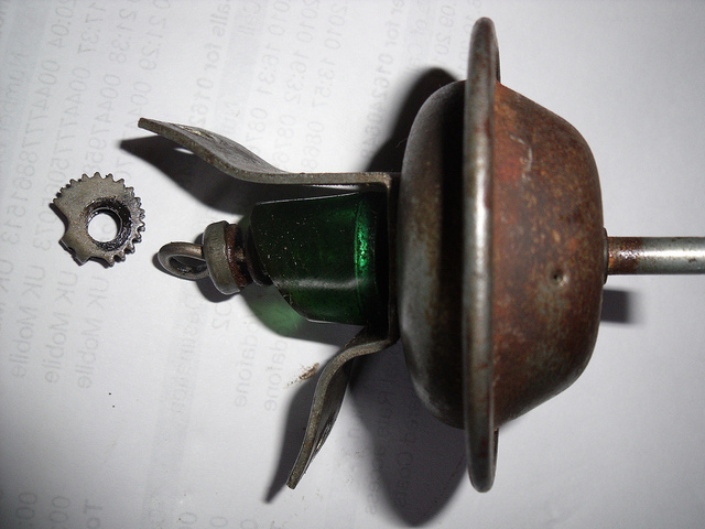

Next question. Is the vacuum capsule definitely shot? I ask because I've just read over on a R4 forum http://www.renault4.co.uk/forum/showthread.php?t=3507" onclick="window.open(this.href);return false; and Googled some pictures (and found my very own )
Vacuum advance 1 by macplaxton, on Flickr
There's a tiny hole in the can, and it needs covering before doing a test....

If diaphragm has gone and mega urgent, there is always the option of carefully de-swaging the capsule and replacing the diaphragm with a portion of chopped up bicycle inner tube....
I'll find that link again later.
Re: Dizzy or Vacuum Advance needed
or just pull the pipe off the capsule and plug the pipe, it wont make a lot of difference to how it runsmacplaxton wrote:If diaphragm has gone and mega urgent, there is always the option of carefully de-swaging the capsule and replacing the diaphragm with a portion of chopped up bicycle inner tube....

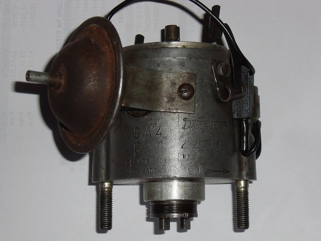

@Malcolm
I think the 4451A is the body part number or something. 525 073 is the number given to the whole thing.
e.g.
Ducellier case 2 by macplaxton, on Flickr
As you can see from the pic, 4431A is to the right. The GD4, GD1 is the mechanical advance curve spec followed by the vacuum advance spec.
But I think the 4451A has a physically different vacuum can attachment of clip over one side, screw in body the other, rather than two screws like the one I posted previously.
e.g.
