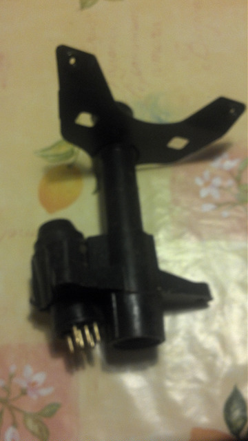

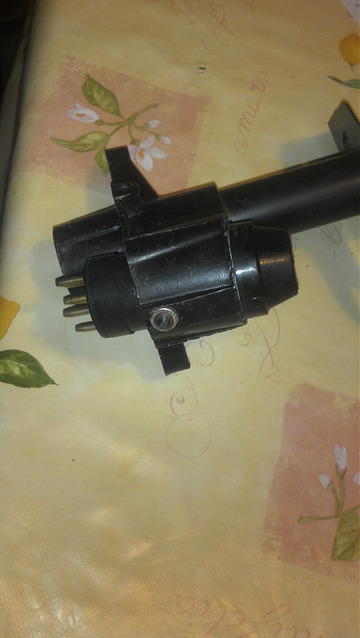

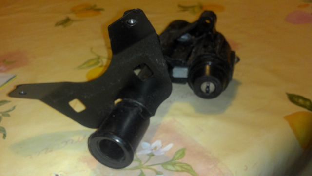

1) Popped the cover panel just below the clocks.
2) Undid the pinch bolt and removed the steering wheel (wasn't rotated to lock when I parked it)
3) Removed steering lock switch multiplug.
4) Undid two upper outer column body bolts from the bottom and four from the top.
5) Pulled the lower dash panel plastic down far enough (it's very flexible) and manoeuvred the upper column assembly out from the bottom.
6) Plugged in the Dremel and whizzed a slot in the top of the shear bolt.
So I've got this far at the minute (sorry for the poor phone pics, misplaced my normal camera):
2013-01-28_19-27-34_716.jpg by macplaxton, on Flickr
2013-01-28_19-28-09_816.jpg by macplaxton, on Flickr
2013-01-28_19-28-35_334.jpg by macplaxton, on Flickr

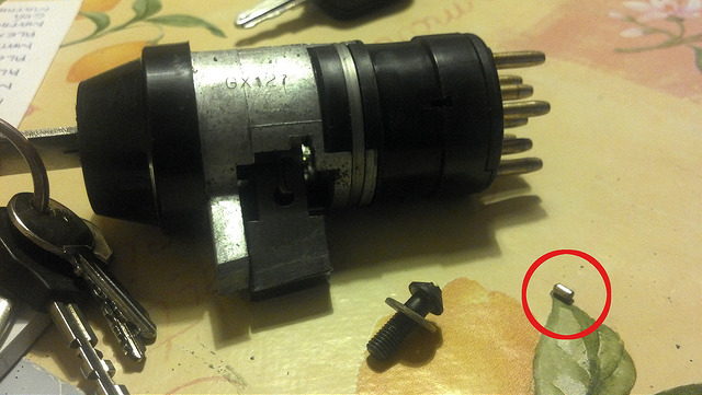

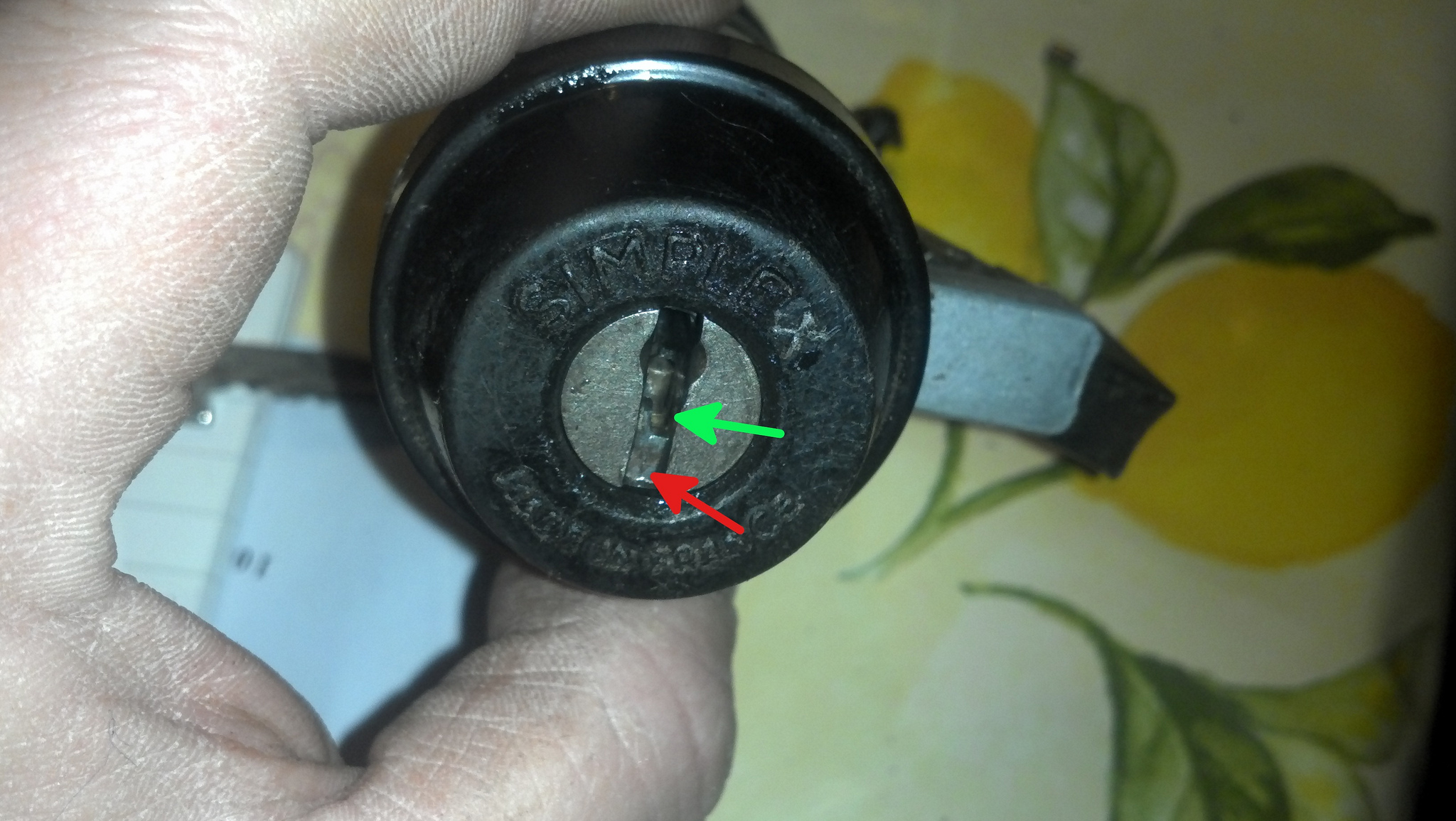

Okay, I seem to have worked round this:
2013-01-28_19-58-04_713a.jpg by macplaxton, on Flickr
2013-01-28_19-58-53_307a.jpg by macplaxton, on Flickr
The first tumbler pin circled in red, had broken off and was sitting at an angle into the lock, preventing key insertion. Once removed the key could be inserted all the way. It can also be turned okay, so I'll live with it a bit longer. The red arrow in the second picture shows a hairline crack at the front of the barrel, with the green one showing where the broken piece of pin came from.
