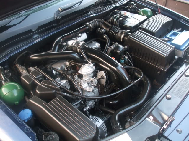

Works van Citroen Nemo engine bay, took about an hour
My engine bay, its a shiny finish but a matt finish is just as easy..
Bonnet done tonight.....16 year old Xantia paint
