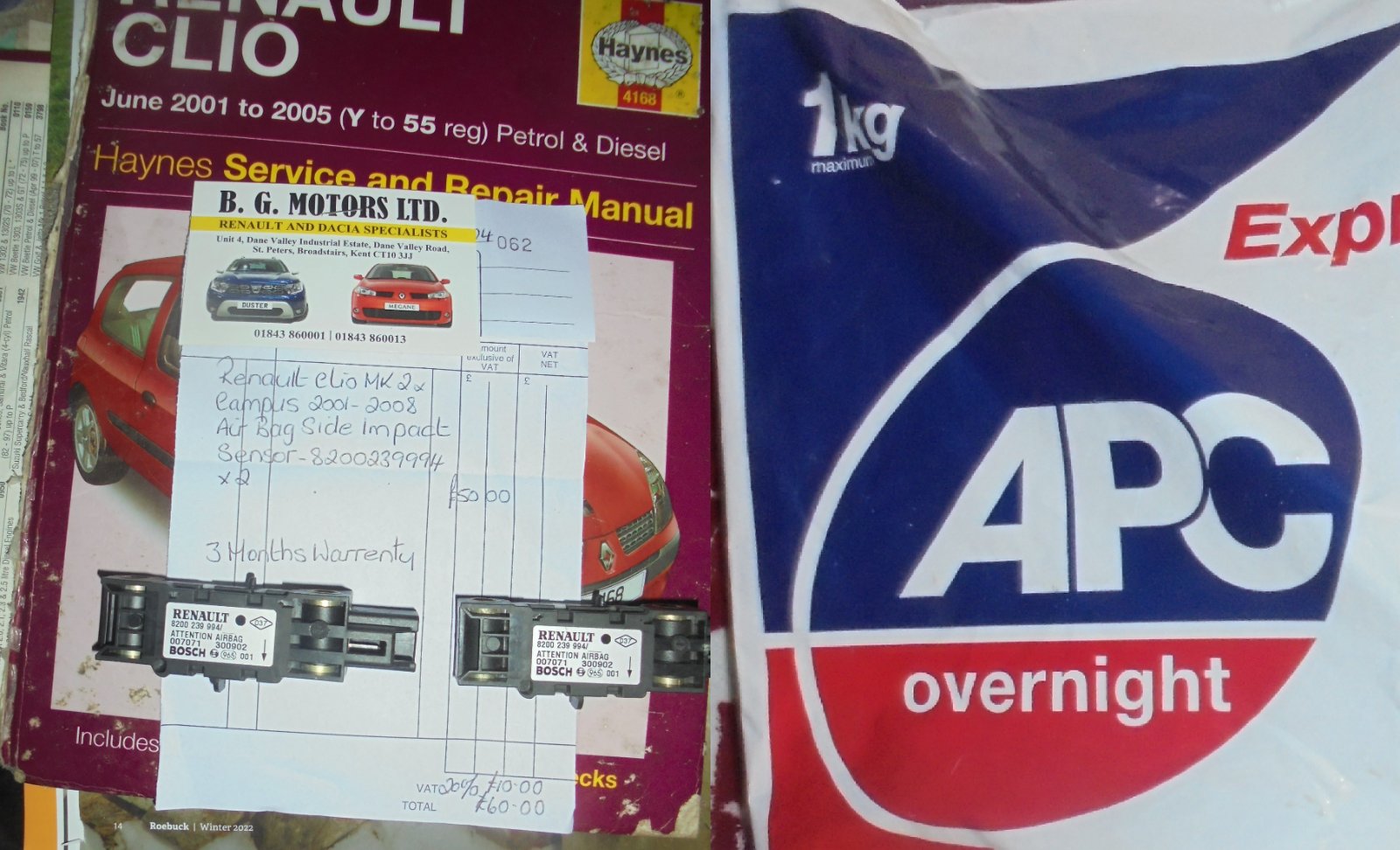

Thanks Jim. I have come to the conclusion that a physical trail round a number of scrapyards is a complete waste of time due to the , now paucity, of Clio 2's of the BB Clio's vintage. The buying process couldn't have been easier and gave the firm some very positive feedback. What I like as well is their good old-fashioned politeness in thanking customers for the feedback given.
I have proved the wiring to all the usual components but without a OBD tool which can read the SRS ECU, and the "tests" it carries out of the components of the system I can't be sure of whether the usual suspects of those side-impact sensors are responsible for the SRS light on.
Now is of course a bit of a Schrodinger's cat-esque moment with as of now 2 possibilities.

...and the results are inNewcastleFalcon wrote: ↑22 Feb 2024, 09:24 I have proved the wiring to all the usual components but without a OBD tool which can read the SRS ECU, and the "tests" it carries out of the components of the system I can't be sure of whether the usual suspects of those side-impact sensors are responsible for the SRS light on.
Alive
The replacement sensors may prove to be the components which solve the airbag light on.
and
Dead
The replacement sensors may prove to be the components which don't solve the airbag light on.
The replacement side-impact sensors did indeed pass the SRS ECU self-test, and the airbag light properly extinguished as it should.

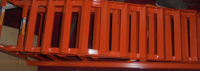

Thanks Jim, the next hurdle does rank high in the DIY car maintenance firmament, of the jobs you really don't want to do. In summary not much more than remove the two bolts or nuts and studs from the manifold to down pipe, a few clamps holding the pipes together, and dropping it down off the hangars/brackets.
I do have these now to aid with access, but if I can bundle the new exhaust bits up and get someone else to do it pronto and for a reasonable price it could save a lot of anticipated sheared-off fastenings swearing.
