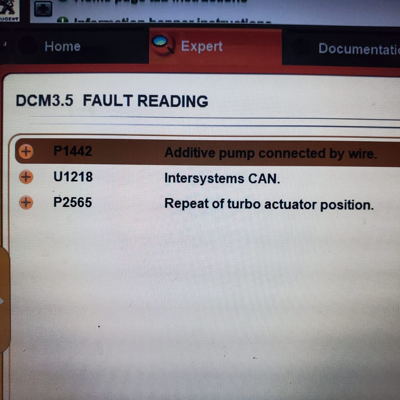

Hello,
Can someone please point to i should check. i have replace the turbo actuator position sensor since fault is permeant with missing or disconnected sensor.
I have checked the voltages on the terminal socket. and measured 5 volts on point 1&2 against -ve terminal of the battery. I believe it should be 5volts between point 1&2.
Does anyone have a connection diagram for the sensor to the ECU?
