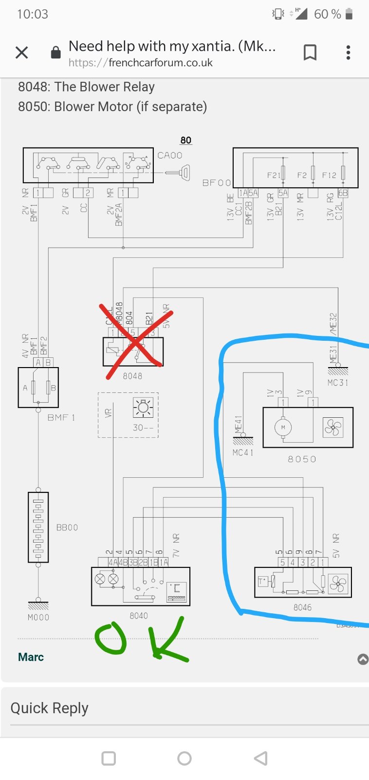

I only have the circuit for the Series 2 Xantia - although some of the heater control panels were very similar between the S1 and S2 models. So bear this in mind when looking at this as it may still be helpful.
Xantia MK II 1.8 Petrol Cabin Heating Controls
8040: Blower Speed Control (if separate)
8046: Blower Motor Resistor (if separated)
8048: The Blower Relay
8050: Blower Motor (if separate)

I'm not very good at reading wiring diagrams and it doesnt seem to be exacly the same as mine, but i suppose the brown connector is for the controls and red(positive) black(ground) but there is another brighter red connector i'm not really sure about. (Is this for rhw?)
Also when the fan worked and would turn off it clicked pretty loud (most likely from a relay) if that helps anything.

Yes, will likely be different as I said this was for a S2. I've looked at the wiring and even the colours are different, so didn't bother putting these up.
Unfortunately I don't have a diagram for the S1s.
